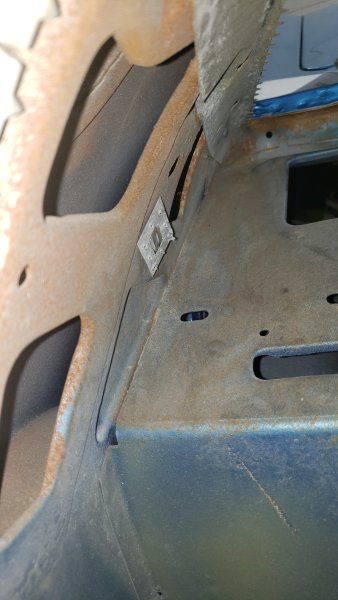

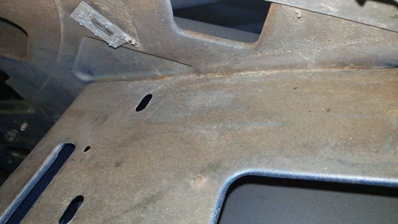

Hi all I got a 69 satellite with sail panels. I don’t have the clips for these can someone please let me know what the clips look like and where I can them from. I tried the usual Google search and I am at a loss.
Thanks

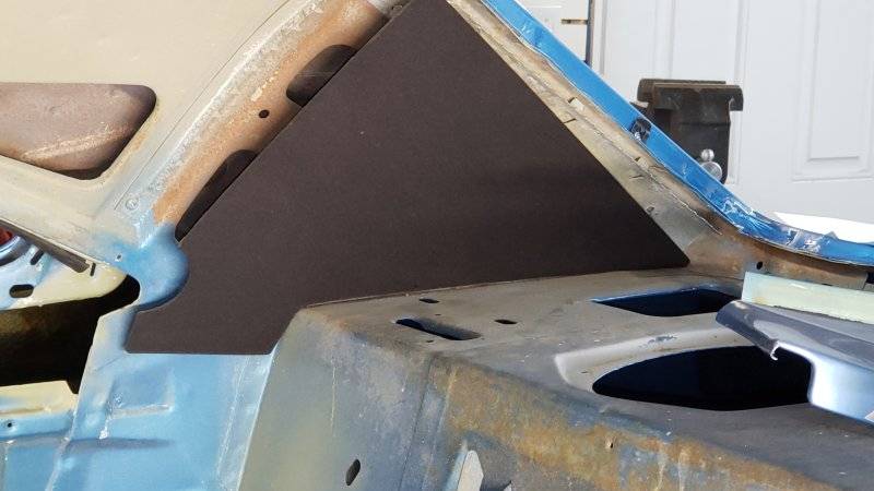

I believe the clips are the same as the door panel clips. The 2 spring wire type ones. That said, some people just use a few strips of velcro due to the repop panels being thinner than the originals which causes the heads of the clips to show through the headliner material once installed.

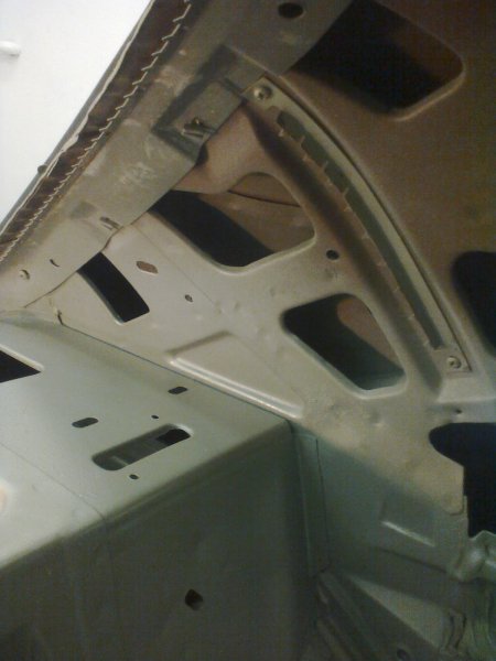

Yes, they are similar to the door panels, and Mine on a 68 GTX were "smashed into my sail panels.
I just marked the position of the clip on the panel and epoxied them back on. They're never coming
