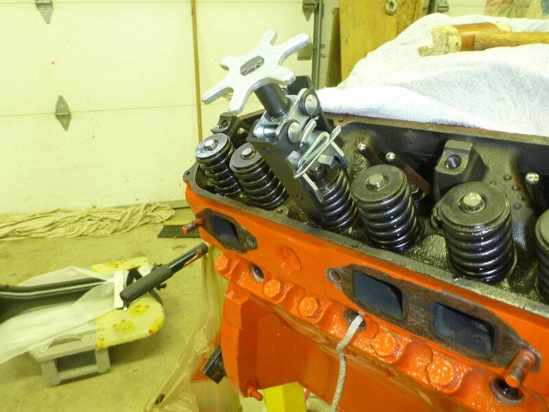

Just use the stock seals you will be fine. Stock has been in there for 48 years. No need to over think or complicate the situation. If you use shop air to hold the valves up do not worry about TDC the air is going to push the piston down. TDC is used when you shove the rope in the hole to hold the valves up. I have several different on car compressors that work ok. This would be a simple and easy to use tool. https://www.ebay.com/itm/2244371677...MIx6mPzbaw8QIVhm5vBB34Jg6wEAQYAyABEgK5Z_D_BwE
Just use the stock seals you will be fine. Stock has been in there for 48 years. No need to over think or complicate the situation. If you use shop air to hold the valves up do not worry about TDC the air is going to push the piston down. TDC is used when you shove the rope in the hole to hold the valves up. I have several different on car compressors that work ok. This would be a simple and easy to use tool. https://www.ebay.com/itm/224437167764?_trkparms=ispr=1&amdata=enc:AQAGAAAAkCVIfln+HunUGoh52MqXJJ2Nvjvn7md9GXVZWQvcStV8hkPWz3GqtGmiK/IGLeYJ5zUR32oIr/wt/ecM077LOPUOp73VapERwSe54U4v6lNs7idia3KHyjKgqTPA1IF7MmqQqqedMgjFfFeIPCKfkg3NsN4z78DRE99sIgKLoWzvQibivRMkhvg5wmMaoMuQxg==&chn=ps&norover=1&mkevt=1&mkrid=711-117182-37290-0&mkcid=2&itemid=224437167764&targetid=1262906534602&device=c&mktype=pla&googleloc=9058193&poi=&campaignid=12873833206&mkgroupid=123950846602&rlsatarget=pla-1262906534602&abcId=9300536&merchantid=6296724&gclid=EAIaIQobChMIx6mPzbaw8QIVhm5vBB34Jg6wEAQYAyABEgK5Z_D_BwE
There is merit in keeping it simple... my plan is to use my air compressor to hold the valves. Tnx for the help...

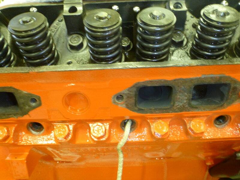

I shove the rope in when the piston is down. Then rotate the crank till it pushes the rope tight doesn't really need to be TDC it's just full of rope and you can't lose a valve.
Note: this is also a great way to torque a balancer bolt.
I use cotton rope and Mahle OEM seals.
