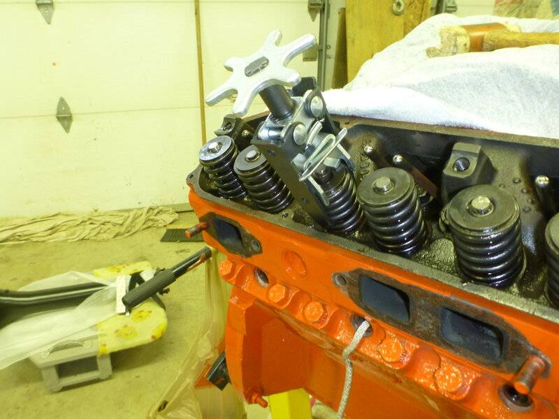

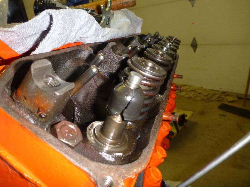

I've only had 1 vehicle do that, my '86 Toyota pickup w 230k miles at the time. Pulled valve cover, pulled plugs, screw in air adapter and fill cylinder w air pressure, remove rocker arm and valve spring, replace stem seal and reinstall. No more smoke. Sold it w a little over 320k miles and smogged better than a new fuel injected car. I know our Mopars w shaft mounted rockers are a bit more work but it's a 1 day job.
With no A/C I could do both sides on a small block in 3 hours. Add a hour for A/C.

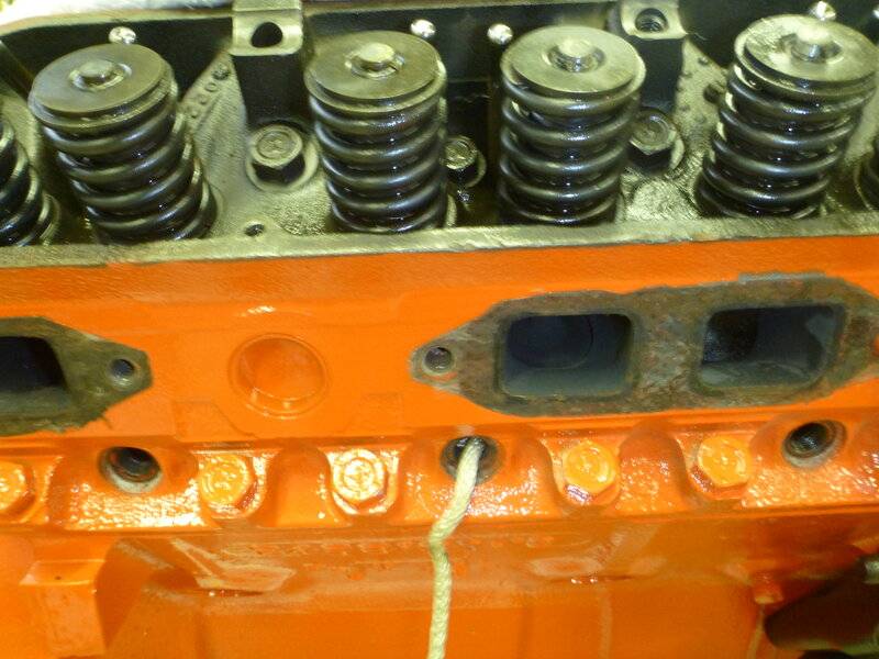

My OE engine shown above was rebuilt (for $325) in 1978. I put new stem seals in 3 years ago before putting it back in the Bee, that and a timing chain and gears (although I could have let the old "silent" chain go). Runs like a top after about 70K on the rebuild and 90K before it. Std bore and still has the OE pistons and probably the cam as well.. can remember anything but the price from back when I was 16. If I was the OP I'd just do the seals and see where it gets him, no point poking the bear...

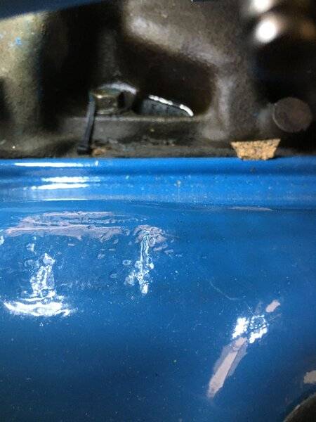

It could be guides but I'm leaning towards an intake manifold to lifter valley gasket. If it were stem seals/guides, the car would smoke every time you did a cold start of the engine. However, a hard stop at a light might slosh oil and get sucked into the intake from below. How is your vacuum? Also check your oil level and never depend on the dip stick. An overfilled crankcase will not vent properly causing a burp in the oiling system throwing oil (internally) everywhere. Overfilled crankcases can also ruin a rear main seal.
Interesting thought.... For years I have been getting a recurring puddle of oil under the intake manifold bolt on the rear side of the #3 intake runner. I can sop it up, and it will return, but it never accumulates enough to run anywhere - just make a pool. This summer I have been chasing the cause of inconsistent AFR. I have sensors on both sides. I can set the idle AFR to 13.5 and tomorrow it may start up and run at 14.5. I figured it was carburation, carb gasket or a vacuum line leak. Have ruled these out as sources of the AFR problem.
