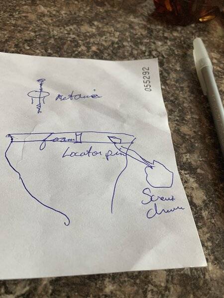

Did u ever say what size motor? If so I missed it somehow. If small block take a big screw driver and tap it in between the block and the intake at the front. Looks like I’ve been treed.
It's a 340. As far as I can tell the intake has never been off of it before. The seal along the front of the intake appears to be a foam type seal - its not cork or rubber.
Somewhere I read that there may be locating sleeves around a couple of the manifold bolts - anyone seen these, or run into them?
There is a locating pin front and rear in the center of the manifold. None on the sides. Use the screw driver trick off to the side of center. 1 side will come up then do the other side. It will be like it’s welded on. Kim
No sleeves period. More mis-information. There should be two locating dowels dead center front the rear on the block where the intake indexes on. Some have them some don't. Just pry it off.
I know what he is thinking now. There is 2 spots on each head for a plastic grommet for lack of a better word to hold the side gaskets in place so u can install the intake without the gasket falling out if place. The intake bolts go thru them. Here is a crude pic. Kim
