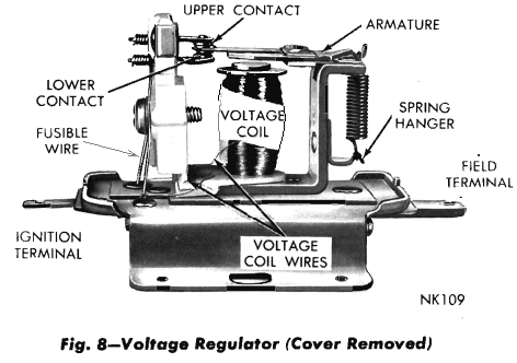

Mechanical voltage regulator? The points/contacts in it might need to be cleaned. Its in the FSM.
