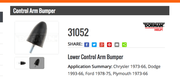

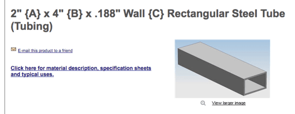

I made a non-adjustable pinion snubber for a 4-speed bracket car. Welded square steel tube to floor pan and used large rubber bumper on third member.

I asked for opinion's--I got 'em. Thanks all. I guess it depends on what you want a snubber to do. I would guess the racers would want that snubber to hit hard and "shock" the tires into the ground. I would be more interested in controlling axle housing twist and limiting how far down the body would travel. I had my springs clamped , which worked well, but did not like the stiffness. Now I am thinking about useing two of the longer lower control arm bumpers( as in Dibbons post) mounted side by side, and a flat plate on the body...........................MO
