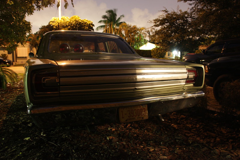

And a few shamelessly off-topic beauty shots:
