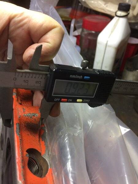

Measure the thickness of the head bolt boss. It should be 1". You can figure out the ccs from there. Its approx 1cc for every .0042 milled The head in the picture was milled .077.
