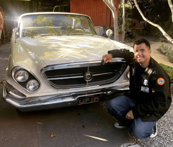

As I finish up my ongoing 68 C Body project, I am already looking into the next. I wasn't planning on it, but my dream car (a 1962 Chrysler) fell into my lap - and selling the 68 would get me the money I need to purchase the car and then some!
It's a '62 300 sport with a 413. She hasn't been on the road in a while but gets turned on once in a while. Went to see the car in person and upon startup (first time in many months) she was smoking pretty bad. It took a while for it to clear up. I would like to keep the 413 but I know pistons are hard to find. Not looking for real performance out of the car, just a fun cruiser with some good power for highway cruising.
From what I understand, any BB Mopar should drop right in, and mate up with the push button 727. I'm thinking either a 383 or a 440. Local to me, I can pick up a '78 short block 440 for real cheap. But it will need parts obviously to be complete. Is that a motor worth building? I wish I could steal the 440 from my 68 and drop another motor into it, but I think that's what will make the car more valuable in the end.
The 300 drives good on it's own accord - the motor just smokes. Would it be worth it to even try to rebuild the 413 with it's original pistons? Regardless, I'm going to get the car. I'm just trying to see what a good course of action is / any advice you all may have!

Good advice, I agree! I definitely wouldn't get rid of the 413. I'd love to make it a nice street motor! I'm hoping that the original pistons might be able to be re-used and I could just do a re-ring / new seals. Not looking to completely rebuild but rather "freshen" up so to say. I'm all new to this stuff, but very eager to learn!

A car that hasn't ran in quite some time could need a little time for the rings to reseal. Throw some Seafoam in the gas tank and put some miles on it. Also in the era before the umbrella valve seals were introduced that could also be the problem. Both will cause the engine to smoke and/or use oil. You can also pour some Marvel Mystery oil or automatic trans fluid through the carburetor to help degum an engine that has sat for extended periods. I would try many things prior to teardown. If a teardown becomes a factor, the heads would be the first thing I would look at. I always go by the theory, that the devil you know is better the one you don't know. If the 440 is cheap enough, for a just in case senerio, grab it. That's my 2 cents.
I'd try valve seals first. Maybe do a compression test and a leak down test.

I would toss valve seals in it and run it for a while. If that has not been driven just started from time to time you can bet the inside of that exhaust is all oil coated. Easy afternoon job with minimal cost.
Forget the 440. Change the valve seals and the oil and drive it. If it doesn’t clear up then Re-ring the 413 and do the heads. You don’t need new pistons on and 83k mile engine.
Thank you all for the great advice!! I think I will go ahead and replace the seals then once I get the car. What valve seals am I looking for? Are they head specific or are they more of a generic seal for BB Mopars?
