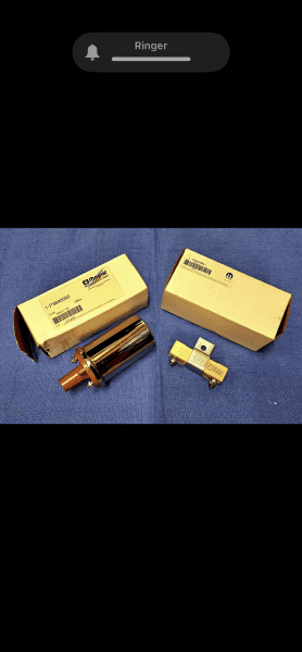

I have a new Mopar Performance chrome ignition coil P3690560 with the proper resistor P2444641 that I may use with a Gold ECU on my Dart.
Does anyone run this set up ?
Any suggestions ?
This car sees both street and track action
Thanks in advance
Any suggestions ?
Thanks in advanceView attachment 1433452

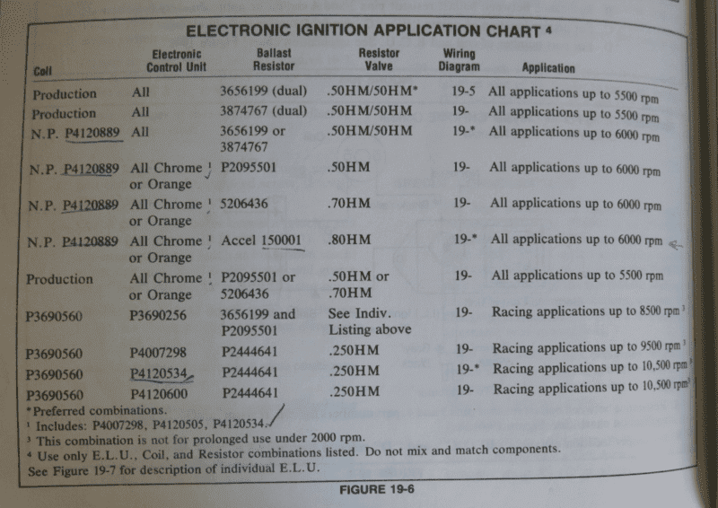

What are you trying to achieve? Does what you have now not function? Just remember that the installed components must be compatible with existing ECU. By installing the mentioned parts, you will not suddenly gain 50 hp....in spite of what you've been told.....just my opinion of course....
BOB RENTON
OK a quick skim here. The gold box is designed to go with the.25 ohm resistor for DRAG RACING where it is shut down between runs and will cool off. If you run it on the street with that combo it needs a higher resistor which will keep the heat down but will lose RPM's in a nutshel. I would find a box for the street by the RPM you will be running and save that box, very hard to find now. Performance will be about the same just not good to 10,000 rpm.

The Gold box is not going to work on the street without excessive heating at low RPM. I tried it once and had problems. Chrome box is a better choice for street / strip.
