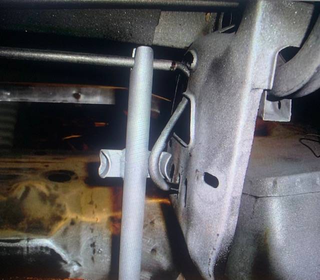

Plus, I've never done them before either....so is there a better way to get them in than fighting with them and is there one that should be in place first vs the other? They are still 'kinda' in place as of now but the lid is off the car. Was thinking about just taking them out all together but well, not sure I want to do that just yet.

hinges up for sure....

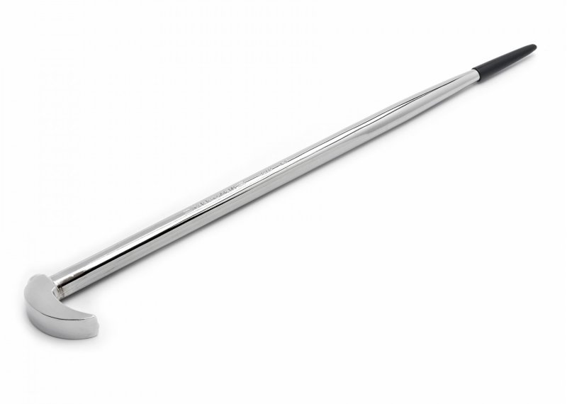

I like that tool! I normally use a pointed prybar like this. Put the tip into the hole you want the spring in and pry it out and let it slide down into the new hole.

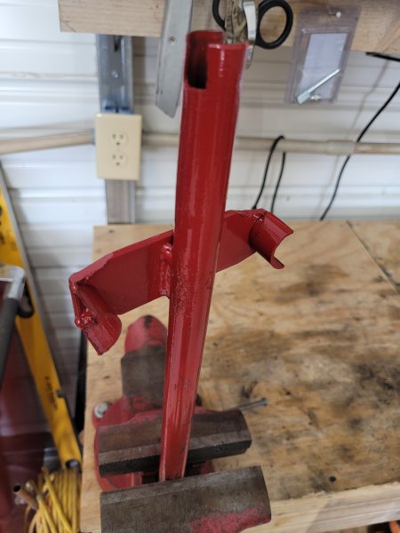

Who ever made that tool is brilliant, it gives you leverage but is small enough for the space you have to work in, it gives you a way to pull the lock out of it's hole... Just a great tool for what can be a dangerous job.. It was easy when I was younger but now I get hurt easier & heal much slower..

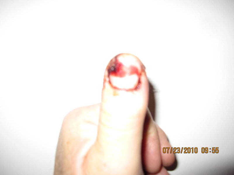

I'll second the dangerous statement! 2009 and still not back to normal. Very close though.

could you provide the measurements so I can build one for myself
Absolutely. I'll get back out to the shop tomorrow and measure it. I basically built this by testing it right on my springs.
Wouldn't mind getting the measurements too while you're at it....

But I like the homemade tool too as it looks to be able to ease the process.
