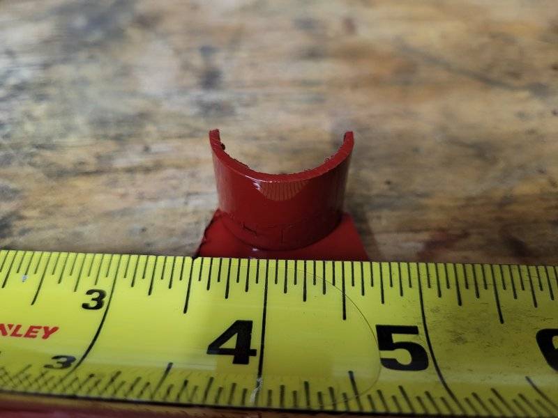

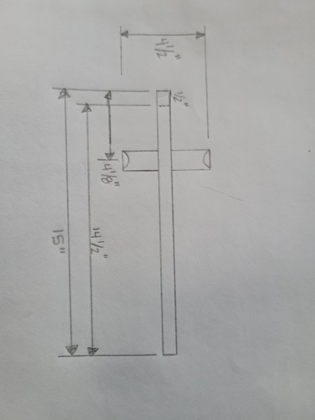

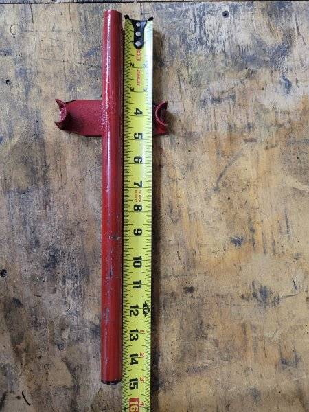

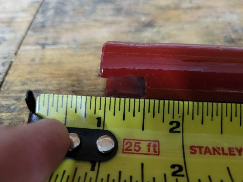

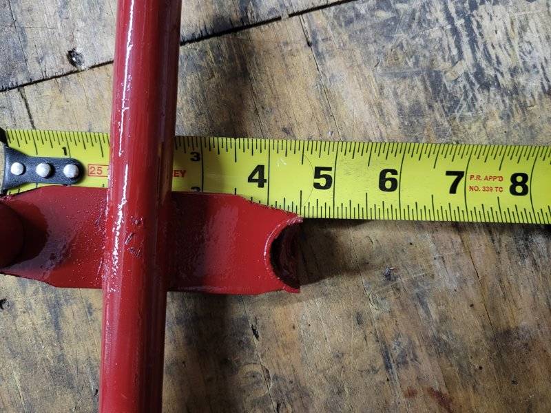

Thank you. Pretty much had an idea what it needed to be but that just cements that thought!Here you go. The 1/2 pipe that hook into the spring are 1" and I think smaller would work just as well. The notch is about 3/8".View attachment 1544857View attachment 1544859View attachment 1544860View attachment 1544861View attachment 1544862
