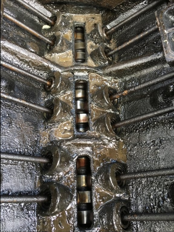

Hi,
I have a 383 that has mostly sat for years only having been started here and there. More recently I noticed it has been smoking a lot out the tail pipes. I checked the oil level and found it was too high (not where I left it last oil change). After looking into it I determined coolant was getting into the oil and drained it, finding runny, chocolate milk looking oil. Today I pulled the intake and valley pan to inspect it and maybe get started on head gaskets. There is a lot of sludge and the cam looks scored to me. This is the engine that came in it when I bought it and I haven't really had it apart until now. I used it as a daily driver in college years ago but it's been driven less than 20 miles since then. I don't know exactly how long they have been mixing. Should I continue with a compression test or do you guys think this engine is done for? I appreciate any help, thanks.

The problem with coolant being in the crankcase for any length of time, is that it is damaging to bearings, cylinders, oil pump and valve components. If you want you can do a though cleaning like Superb Bee stated, and see how it does. Ideally, a couple of bearing caps should be removed for inspection and if effected a rebuild would be needed.
Coolant and bearings do not play well together. Judging from the looks of the cam, I'd be very concerned about the bearings.

With all that sludge in the motor, should be well preserved. Yeah, if water got to parts for much length of time, could be looking at some rust. But, from your photo, don't see any.
Cam doesn't even look all that bad, considering the sludge, that's from long over due oil changes, or crap oil, or both.
But, you'll never know, until you bust it ALL the way down. Something that motor needs real bad. That thing needs a complete overhaul! Have you pulled the heads, and gaskets? Have seen just a head gasket go bad, at the right place, that would let water get into a cylinder, or the valley.
Pull the heads, examine the head gaskets, and look in each cylinder. If one cylinder wall, piston is rusted, could (or couldn't, because of the gasket) be a cracked cylinder wall.

Thanks a lot for the replies guys. Yeah I'm in San Diego so nothing got cold enough to freeze. I noticed the engine smoking for the last few months but it was only started once and a while on a weekend. I'm planning on pulling the heads this weekend or the next to get more of a look at the cylinder walls. Otherwise I may soon be investing in a 522 crate engine from CME. Again, I appreciate the advice.
