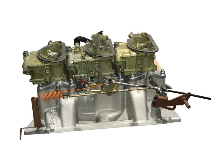

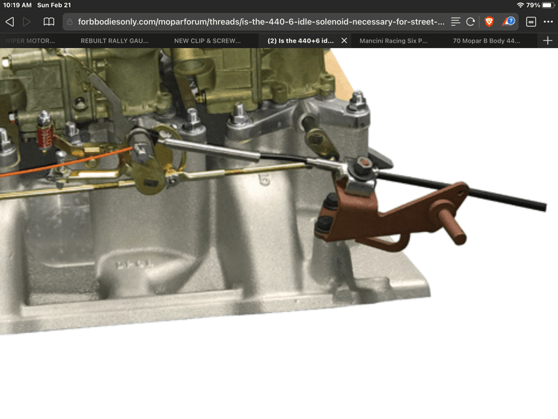

Throttle bracket (not sure if correct for manual trans after removing kick down rod) picture same as Mancini bracket pictured below. What does correct original look like?

Throttle bracket looks like below

As far as the throttle cable bracket I think its right.
thanks. Just looks funny with that finger dangling and not touching anything
