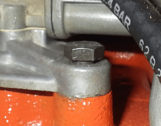

Bolts attaching the carbs to the manifold itself.

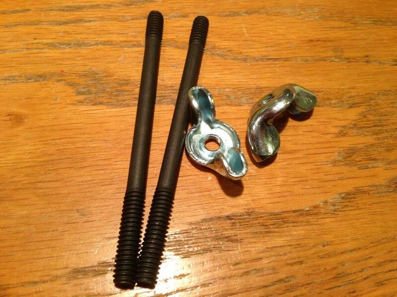

studs with wingnuts to attach the air cleaner to the top of the carbs
Are these bolts with the H on head correct?
I believe the bottom cleaner studs are '71.
The carb bolts look like the repops I have. My cast intake has a couple holes that are not deep enough for them, even after chasing with a bottom tap.

carb to air cleaner studs A and C appear to be th eexact same, just different camera angle.
Studs with the shoulder is right for 70-71
Carbs bolts with the H on them is also correct for 70-71
Do you or anyone else here know how long the carb hold down bolts should be?
@Daves69 how long are yours, that are too long?

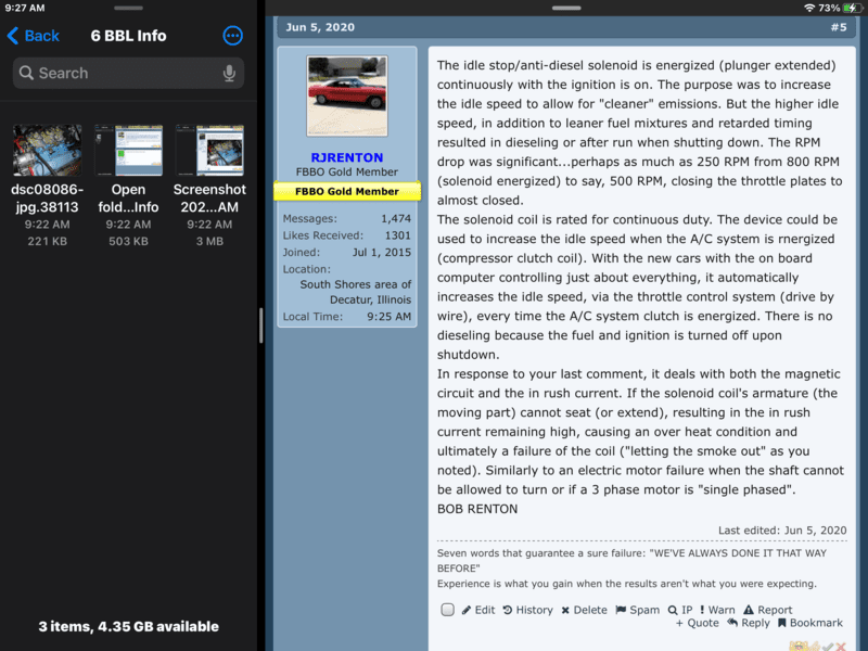

Certainly agree the idle solenoid isn’t needed. My 71 had one when I purchased the car in 1982 so I ran with it. It wasn’t the original DR1114443. It had been replaced with a 1970 DR1114429 solenoid sometime during the cars first eleven years of life. Funny thing is I just this morning replaced the 1970 solenoid with a “rebuilt” 1971 solenoid that I purchased a few months ago. Very pricey but that’s what happens once you start down the correct numbers restoration path.

Here's my thing, on a 69 1/2?
There's NO wire from anywhere to energize solenoid. Ive seen them on 4 speed cars, but have never seen where from which they come?! (Out of the wiring harness) that is..
That solenoid is not needed it was a anti dieseling thing they came up with. It was hooked up to the Electronic advance (vacuum with a solenoid) to retard the ignition timing 5 degrees (why the ignition is off) and the same time un energize the solenoid. One of Ma mopars finest moments if you ask me! NOT!
Not on the six packs, had nothing to do with vacuum advance
I'll have to look into that, my distributor is just been sitting on the shelf for many many many years, but I still do have the original to my engine. maybe I'm forgetting
