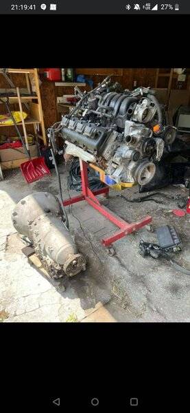

Hey everyone, I'm looking to get some advice. I have a 1972 with a mild 340. 340 has a 268 Lunati cam, x heads, and summit headers. Runs great. A guy near me is offering a 2006 5.7 Hemi and trans for 1200.
This is a complete power train motor, trans, torc converter, PCM/ECM and wiring harness, with electronic gas pedal and receiver. It is currently set up in a Milodon oil pan with a custom oil pick up set to go direct into a B-Body Mopar. It also comes with the motor mounts to bolt direct to the K member of any B Body(unsure of 72 fitment) and an oil filter replicator kit.
Any opinions on the deal? I understand I may spend an additional 3-5k to swap myself and I plan to use my 727 trans.

To be honest, nothing is wrong with the 340. It runs and sounds great, but I did plan on putting an efi and torqstorm supercharger on it to get a bit more efficiency and power in the future without breaking the bank.
Then I started comparing cost of just getting a g3 hemi to the money I'd put in the small block and that's when I ran across this deal.
If I got the hemi, not sure if I'd sell the 340 to cover my costs or keep it. It's not numbers matching but it's a good engine.
I’d be all over that. EFI, can’t beat it. Starts right up, always adjusts for better drivability. But ya need to consider other costs, my best guess at today’s prices would be 3k using your trans. Add another 4K if ya use the Nag1. If your not capable or have the tools needed for tunnel work so you can use the Nag1, stick with the trans you have. You’ll need a different flywheel to use a 727 or 904. You’ll need to go through the harness of the donor or by a harness already done. The computer will need to be sent out to be programmed and get rid of security stuff inside of it. You’ll need headers. There’s a lot of work, $$$$ and time to do this. I say, get to wrenching.
The oil pan and mounts is nearly $750 just there...

I would recommend that if you are going to do this add an overdrive trans
to do all this work and still have three gears ?! I don’t know I’ve don’t two swaps
1. ls with t56. Converted auto 3 speed to t56 with six speeds... love to fly at 80-90 mph on vintage cars on highway
2. l76 with 6l80 six speed auto. Ditched 3 speed th400
Once you have the efi you can drive it daily but not sure about doing that with a three speed

Edelbrock has a new series called Proflow 4+. It is an engine management system for late model engines. They have one for the LS, Coyote and the Gen 3 hemis. No cutting harnesses, flashing ECU's etc. Sell the OEM stuff to help pay for the Edelbrock system. Done.
I’m sure it’s a good system and I looked into it but I don’t believe any aftermarket efi can match the oem efi, the parts available over the counter alone is a huge advantage plus it’s pricey almost the same or more by the time your done
