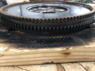

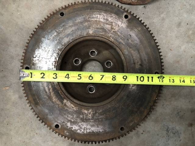

Well i tried to imply that i would find a shop that could....and then find out how much. If it's $15, sure, cut it and lets see what we've got. If the "cracks" go away, then you're good. If not, youre out $15. If its $75, it's shopping for a new one time.
A new flywheel might be an excellent investment in peace of mind.

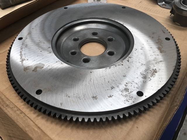

Think I'd go with a heat cracked USA made one before going with a Shinese oneI bought a new one from Jegs for right around $100,, but its Chinese made
