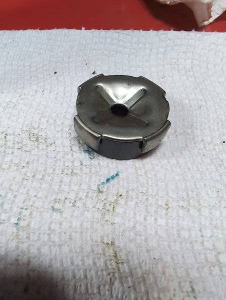

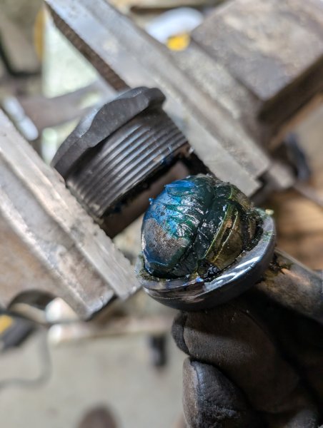

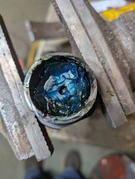

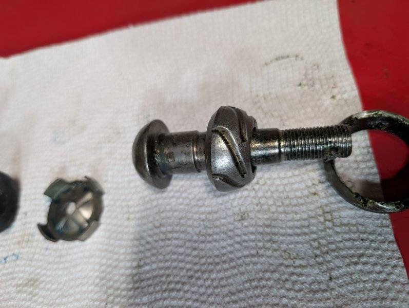

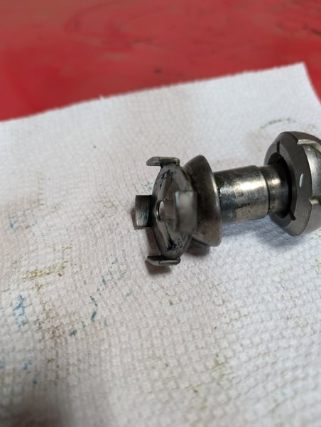

Ok for science I spilt one open. Any questions - I don't know what an original looks like inside TBH.
I bought a pair and they look great to me just like I remember them back in the day.
Thanks for the tip.
And I bought tie rods and they look fine also.
Someone mentioned they might have plastic inside, are there any plastic components?
I said that based on a lot cut open by a popular YouTube channel.
Amazon description says, "
  • PROBLEM SOLVER GUSHER BEARING -- Metal-to-metal design provides strength and allows grease to flow through bearing surface for reduced friction and long life"
At the bottom under a concave stamped steel part there is a plastic or urethane piece (also concave on the top).
