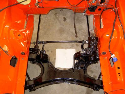

Not to sound like a dumbass, but this is my first classic car and I'm fairly young....how is the "k" frame identified?
Cross member under the engine....looks like a K in it's design. Not the best pics but here's 3 in various states of modification. The driver's side is standing on the floor and the front is the left.
Awesome, thanks guys, that last pic makes it a bunch more clear....I'll get under there and see for myself and inspect it for any signs of weakness.
