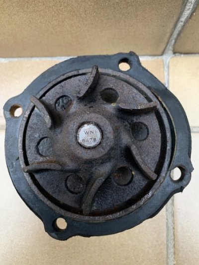

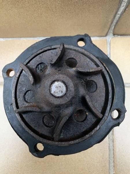

Today we replaced the water pump on my 69 charger with a 440hp (crappy 4-5 hour job without removing the radiator) and this is the old water pump which was leaking.
Is this the original one and if so can it be rebuilt?
Otherwise it goes straight into the trash.

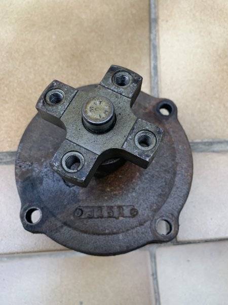

Since there is no pentastar on it and searching "J158 water pump", "mopar J158" etc. does not turn up any results i tend to believe its not original.
But i would like to be sure before getting rid of it.
Older style cast impeller. Might have cast number under it. Can be rebuilt, but probably not what someone looking for were having outside markings might be more important.

The bolt holes on the impeller are of the old style and not the slotted ones used on aftermarket. It looks like a old casting too.....so, yes sir.....it probably is. They can be rebuilt, and even if you do replace it.....save the old one....they are getting very rare.

Today i looked at the pump again and there are casting numbers i have not seen before because you can barely read them.
The most important i think reads 2402921 which is a legit mopar number so the pump seems to be original.
Look and mileage (90k documented) also support that.
That means i will keep it.
If i should decide to get it rebuilt: Who does a good job with that?
I obviously would want this exact pump back if i should send it in because its original to the car.

I do not think that impeller style is original for a 69 440 HP. It would have been stamped steel.
Home He rebuilt my original last year. I was pleased with the work!
