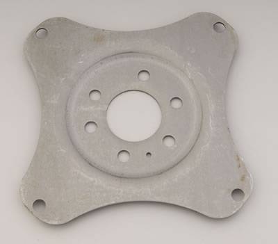

Is this what I need to rear balance my 5.9L?
1966Coronet
4:04 PM
Mar 18, 2012
74
6
charlotte, nc
Hey Guys is this the flex plate that I need to rear balance my 360?
most have a weight on the converter but you can run a B&M weighted flexplate and a standard converter from a 340 or 318... the B&M is completely round with with a notch taken out of it.
Is yours 5.9L or 360LA?
Quote from another site.
"Although the pre-Magnum ('71-'92) and Magnum versions of the 360/5.9 are both externally balanced, the two are balanced differently (the 360 Magnum uses lighter pistons) and each requires a uniquely balanced damper, flywheel, drive plate, or torque converter."
so if 1993 and later 5.9L magnum...no.
If 1992 and earlier LA360, then maybe, depending on converter.
B&M has 2 different plates for 360LA/904...BMM10239, or 360LA/727...BMM10236
