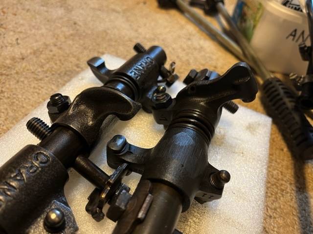

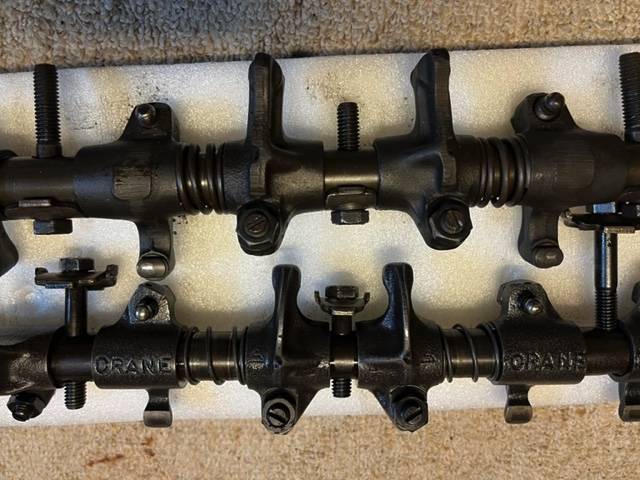

I have two set of ductile rockers for BB, Crane and Isky. The Isky is the rough and heavy one of the two. Which one is the "best" one for a street/strip engine with a SFT cam?

Might be the angle, but one set looks smaller [ small block? ]. I would use the Crane because:
- The Iskys are overly large at the valve tip, adding unnecessary weight for the springs to control.
- The Crane has a wider web where the prod section meets the main body, adding strength in a critical area. Going by the pics.
Both sets have no sign of wear. A friend bought the Cranes in the early -90 and hi seldom fires that engine up.
I go with Geoff 2 here, Crane looks more well thought out of the two.

I too would use the iskys, the wear pad is a much better more durable design
Use the Cranes... Send me the Iskys... I'll dispose of them for ya.... Iskys aren't perfect, typically need machine work to narrow the area that rides on the shaft so the tips center on the valves... They are bulky at the valve end which can interfere with short valve covers, you ned to either modify the baffles in the valve covers, use aftermarket valve covers or use valve cover spacers... That bulkiness also makes then able to handle very high spring pressure without failing... The Iskys are bullet proof once properly set up... BTW those wear pads that contact the valve tips are hardened... As are the adjuster screws...
The Cranes have metallurgy issues with soft adjusters, soft valve contact areas & galling to the shafts...
Nah .. you just need to trim the little tabs off the stock hold downs and they fit fine.
regardless of which the OP uses, be sure to use a thin shim between the rockers and the pedestals or you'll end up with iron filings in your oil pan !!
And FWIW, there's absolutely nothing wrong with using the springs on the shafts between the rockers instead of spacers. Hell, they were used on every Gen I and Gen II hemi !! And the bonus is you don't have to dick around shimming for side clearance !!
