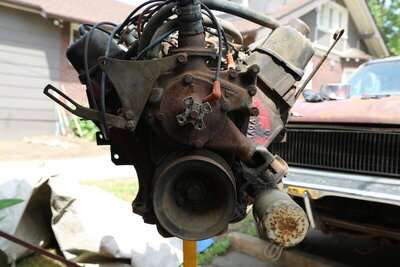

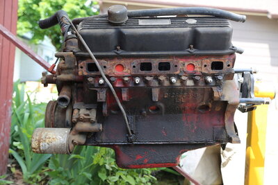

I dropped off the 383 short block at the machine shop for a "slightly better than stock" rebuild, shooting for around 400hp. Nothing crazy, just want a fun, reliable cruiser. I've pretty much decided to get the Sidewinder heads from Marsh Performance, not sure what camshaft to get or if the one in it will be reused. I don't know the specs on what's in there. I've been buying stuff for the car for the last four years without having a "plan", so I have a 1411 Edelbrock 750 I'll need to rebuild, a Performer intake, a complete gasket set and a four speed setup. Any suggestions on which camshaft to get or if the one it has can be used, assuming it's a stock or slightly better than stock grind? I'm beginning to suspect the Performer intake might hinder the heads too much? If they end up boring the block to .060, are the .040 pistons worth anything in resale? I don't think it has many miles on the last rebuild, has a barely noticeable ridge, but I didn't want to spend all the time and waste a gasket set and have it end up being a smoker or something. Help me out here, oh wise ones! Remember - I'm going for a stout cruiser build, not some 500hp monster that I can only drive around town. I'd like to take this on back-road trips now and then, although the 833 might need to get a Passion 4th gear for true highway cruising. It's a 3.08 open rear, but I wouldn't mind a sure grip with similar or higher gearing in the near future. And yes, I (or the shop) will be painting the block the proper turquoise, but I think I'll be keeping the aluminum heads and intake natural color? It will have black headers and I think maybe the black Mopar Performance valve covers, although if I end up painting the heads and intake, I'll use stock valve covers to complete the stock look. Thoughts? Insults? Scoldings?

Wow, that's a beauty! The machine shop said it would take them "about two weeks" to do the short block, so I have to get busy ordering whatever camshaft, heads and maybe intake I'll need! With the black headers, I think I'll repaint the MP valve covers black, but that engine of yours looks GOOD!
That was in a 63 Dodge 440, that too was a 383. You will be fine, just make it "yours".
