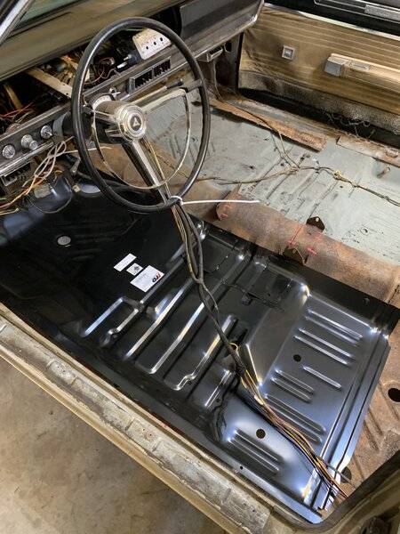

......yes....that is a mo-fo for sure.....but, I guess the best technique is to cut out the pan middle and work the edges like that one....with it open.....
I'm doing one now. Engine and trans are out, but I think I will leave that front firewall pinchweld alone. Going to trim the front lip off of the AMD full pan, leave about 1" of the old floor attached all the way across, and use panel bond to attach. The pinchweld flange looks pretty shallow, and I don't want to mangle it, as it is very clean and solid. The panel bond will attach it as well as seal it. Then some more seam sealer to be safe.
That flange is narrow. Even from the factory they welded along the seam inside the car.
Starting fitting. May leave seam at top alone.... as it’s in great shape.....
