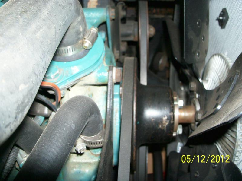

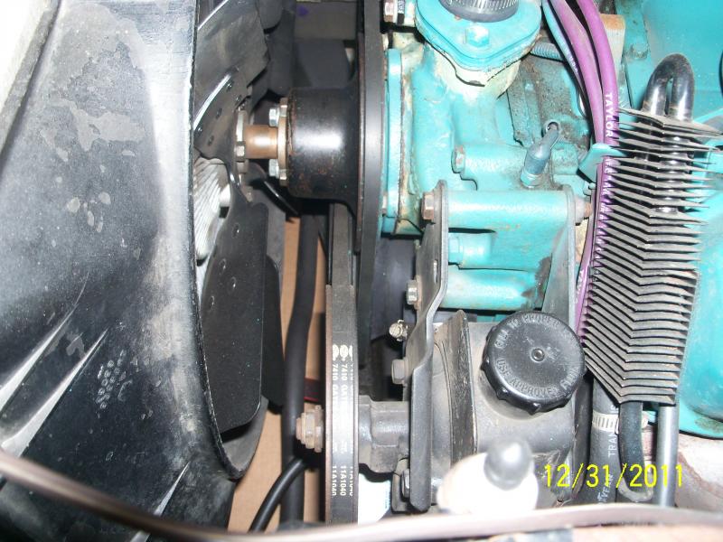

I bought an engineered products radiator. It's a 2 row 1" 26" it went in perfect. I found it on ebay, their still there with high rating. I'm using a clutch fan from an 87 power ram 350. It's a 20", the shroud is from an 85 fifth ave.. I'm running a 451 with stealth heads etc.. I've never seen over 195 on the hottest days. The total fan shroud setup was 50 bucks. I did have to notch for the upper hose and I cut a clearance for the oil filter. It's a 72 satellite. Hope this helps.
