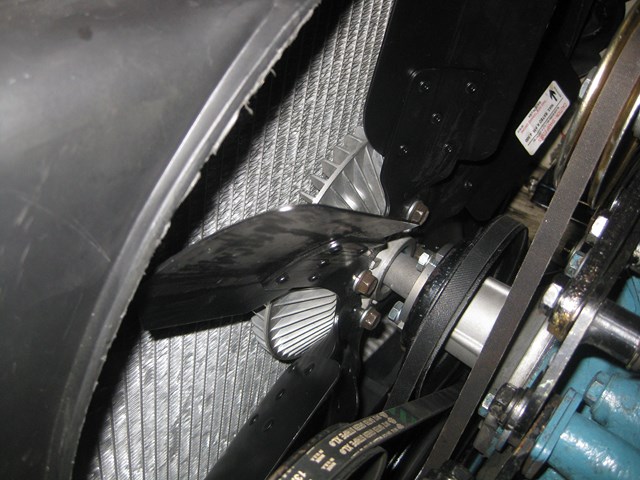

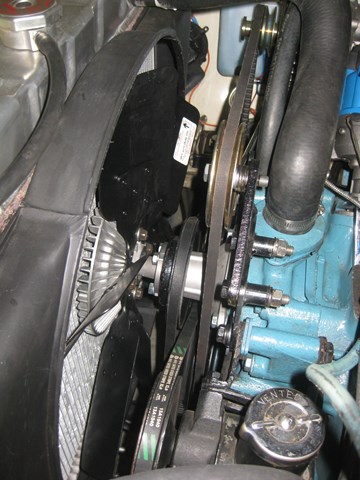

I was able to get the shroud to fit, but there is minimal clearance from the fan shroud to the fan blade. Around 1/4-3/8".
I'd like to switch from the 18" fan to the 17.25" fan. Part # is FLX 5717. Same rotation (clockwise). Think this is undersized? This will get me half inch clearance from blade to shroud. Is this enough?

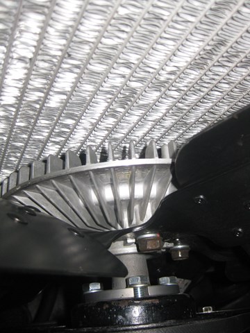

here are some pics from today... the fan is a 19 " flexalite with flx-5555 fan cluth
1/2 " .. is very close...but if the engine is not moving so much.... ?? Perhaps it is an try and error situation...

Hi Juergen, I mean the distance from the fan blade to the shroud. Just want to make sure we're not talking about the distance of the clutch to the radiator.
the distance from the fan blade to the shroud is @ 1/2 to 3/4 of an inch..but I will check it out tomorrow..to tell you the 100% sure numbers.
Greetings Juergen
P.S I will also check the distance from the chutch to the radiator....

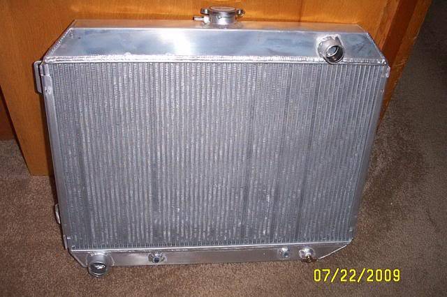

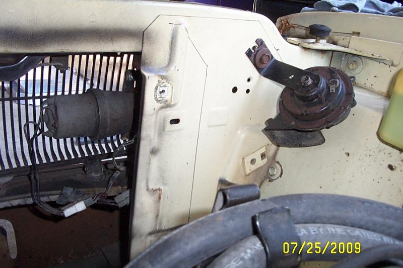

I got 3 aluminum radiators off ebay for under $250 shipped to my door. Radiators are 2 rows of 1" tubes, direct drop in for a 26" Mopar big block. Has provisions for stock fan shrouds as well. I did have to cut out the passenger side core support for the 66 Charger that had a 22" radiator originally, but I took my time and it looks stock. I do not have a fan shroud on my 66 Charger, only the Daytona pictured above
Ebay seller name is "Engineered Products" if I remember....I got all installed in my cars...all overheat issues cured, even in the Daytona. Running non-thermal clutch fan with metal 6 or 7 blade fans.

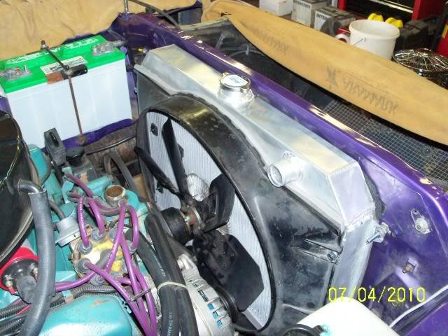

Hey A383WING, happy new year. I'm ordering the radiator from the guy you recommended. Just wanted to confirm something with you. Did you have to modify the fan shroud to get it to bolt up? Is it the mopar fan shroud? also, what diameter mechanical fan are you running? I have an 18.25" fan.
Just trying to cover all bases. I hate surprises...
I did not have to modify the shroud, what I did do was install studs and loc-tite them into the radiator and use nuts & washers to attach the shroud. I did not like how close the sheet metal screws came to the fins. I just tapped threads into the holes and installed studs. I ferget what fan I'm running....either 18" or 19" if I remember.
These radiators are 26" style, I put these in place of the 22" rads in all my cars...I also cut 4" out of pass side rad support. You will have to drill 2 new holes for mounting on the passenger side. I had to open up the slots in the new rad for mounting screws to go through easy also. These are pretty much a drop in radiator, but you might have to do a little work. Only issue I had was I had to find shorter fan clutch...because aluminum rad is a lot thicker and I didn't like how close the fan blade was to the fins.

my cars were 22" rads originally, I cut part of support on passenger side, that's all. My cars are put away & covered up for winter...can't get to them right now....if you are getting the rad from ebay seller, he has all dimensions listed in auction

my Charger has 160,000 original miles, engine never touched...still had OE radiator in it...to re-core my OE radiator was over $500 from many places around here...I opted for the aluminum rad so I could drive the car again..
I was still running all the original components the way the factory intended..it just kept overheating...rad was plugged

Update: installed the 26'' radiator purchased off eBay. Fitment was great. Factory fan shroud bolted right up. There were provisions for the shroud but I did have to drill new holes in the radiator mounting tabs because they didn't line up exactly.
I installed the 440source Waterpump housing with drivers side inlet. Fitment was good. All holes bolted right up. Power steering pump bracket and alternator brackets fit no problem without the need for shims. Overall, I was super pleased.
Total install time was 7 hrs including two or three trips to the auto parts store for hoses, rad mounting bolts, and rtv gasket. I had access to a lift and power tools. I did stop for lunch and to check and replace the spark plugs.
I went for an hour drive after, through Philly with some moderate traffic and red light stops. Temp never registered above 205.
Greetings Juergen
HI Juergen, just wanted to let you know. That fan you recommended is only rated to a max room of 4000. Not sure if you knew that. I noticed today
