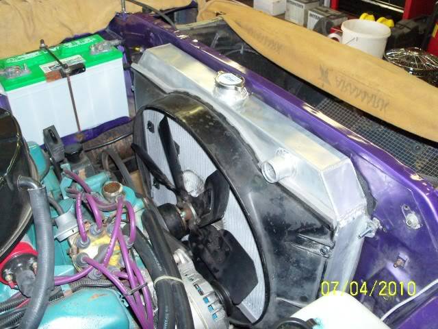

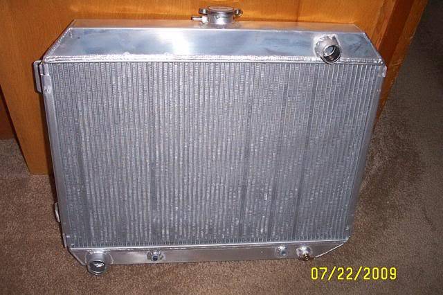

I got 3 aluminum radiators off ebay for under $250 shipped to my door. Radiators are 2 rows of 1" tubes, direct drop in for a 26" Mopar big block. Has provisions for stock fan shrouds as well. I did have to cut out the passenger side core support for the 66 Charger that had a 22" radiator originally, but I took my time and it looks stock. I do not have a fan shroud on my 66 Charger, only the Daytona pictured above
Ebay seller name is "Engineered Products" if I remember....I got all installed in my cars...all overheat issues cured, even in the Daytona. Running non-thermal clutch fan with metal 6 or 7 blade fans.

I have a electric pusher fan attached to the front of the radiator in the nose cone of the Daytona...but ever since I put this new radiator in, I have never had to turn it on, even on stop & go traffic and the small opening in the nosecone.
I took out a 3 row brass radiator, it had small tubes, maybe less than 1/2" for each tube. The new aluminum radiator has only 2 rows of tubes, but each tube it 1" wide, so this rad holds more water than the 3 row unit....and that's what's needed to keep engine cool, more water = better cooling for engine

I guess I'm a little confused....I'm running one of his radiators with stock fan shroud in the Daytona....I got a 19" fan blade in there..fits perfectly

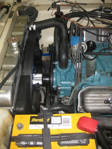

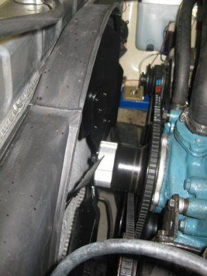

hello am3rican
here is a pic from my set up... the only difference is that I am running a fan clutch now... not a fixed fan

You can buy a water pump housing(Summit,Jegs) like you need to put the lower hose on the driver side. Then you can find a rad to fit. Try Champion Radiator Google it. I gave $150 for my alum rad. Direct bolt in. Now a standard MOPAR small block T stat fan and clutch keeps my 440 cool with A/C.
yea...change the WP housing to drivers side inlet...then find a correct radiator to bolt into car
champion radiator,2765 jag clutch,idles at 180,,stock shroud just showed up today
