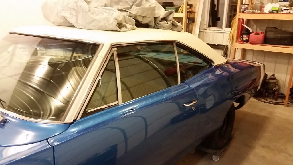

Can you outline the assembly steps/order that work best for installing the vent window frame, side glass and its tracks for the doors? I wrestled these parts out to get it apart.
Thanks
Jim
The vent windows are pretty self explanatory, they just drop in. I aligned them with the drip rails, then tightened. Don't forget to tape the top of your doors to avoid damage to the paint. Go back to post 168 and read, I have a step by step on door glass assembly. Any other questions, feel free to ask.

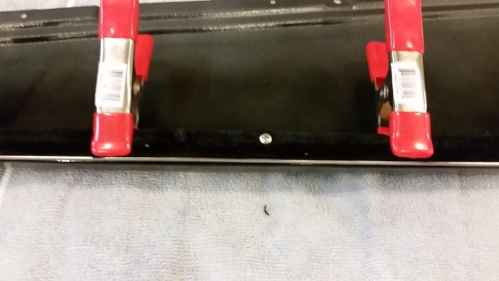

Tonight's project, install cat wiskers on quarter panel interior panels. Actually worked better than I expected. I used #6 × 1/2" stainless screws. 6 per side worked well.
After you tighten them up the basically dissappear.
Yes there is a screw at my finger tip. Here's a pic of the screws. Pre drill with a 7/64" bit.
