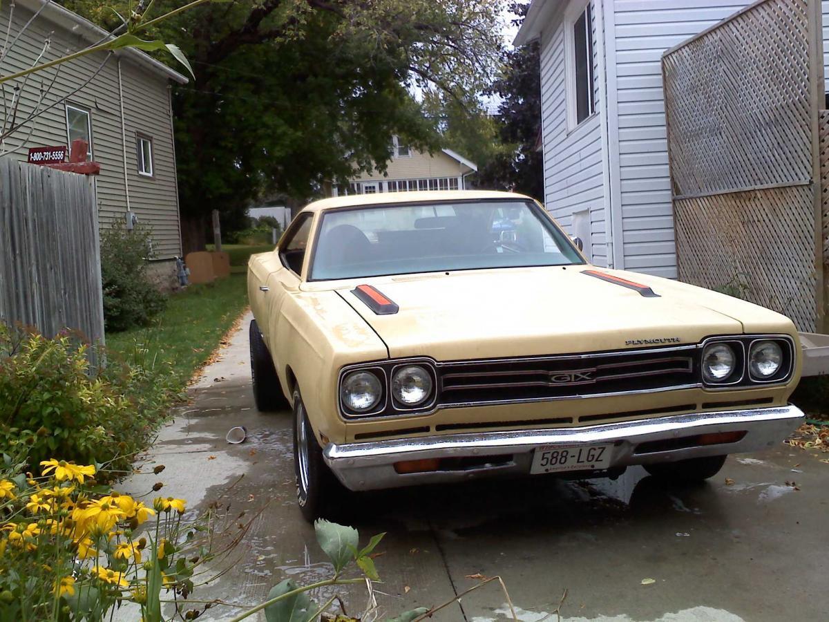

the car i gave up

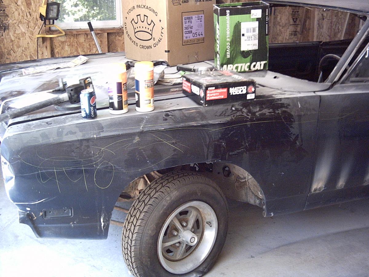

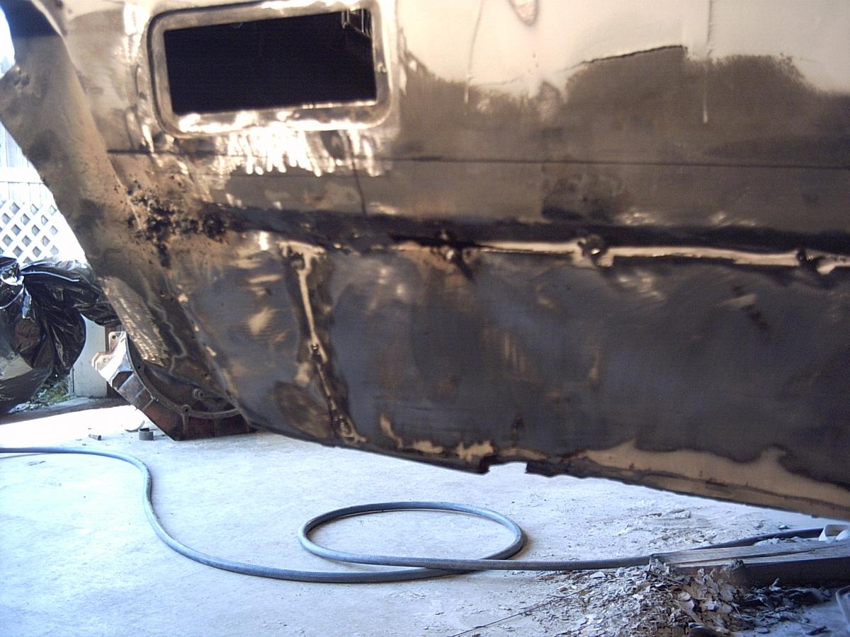

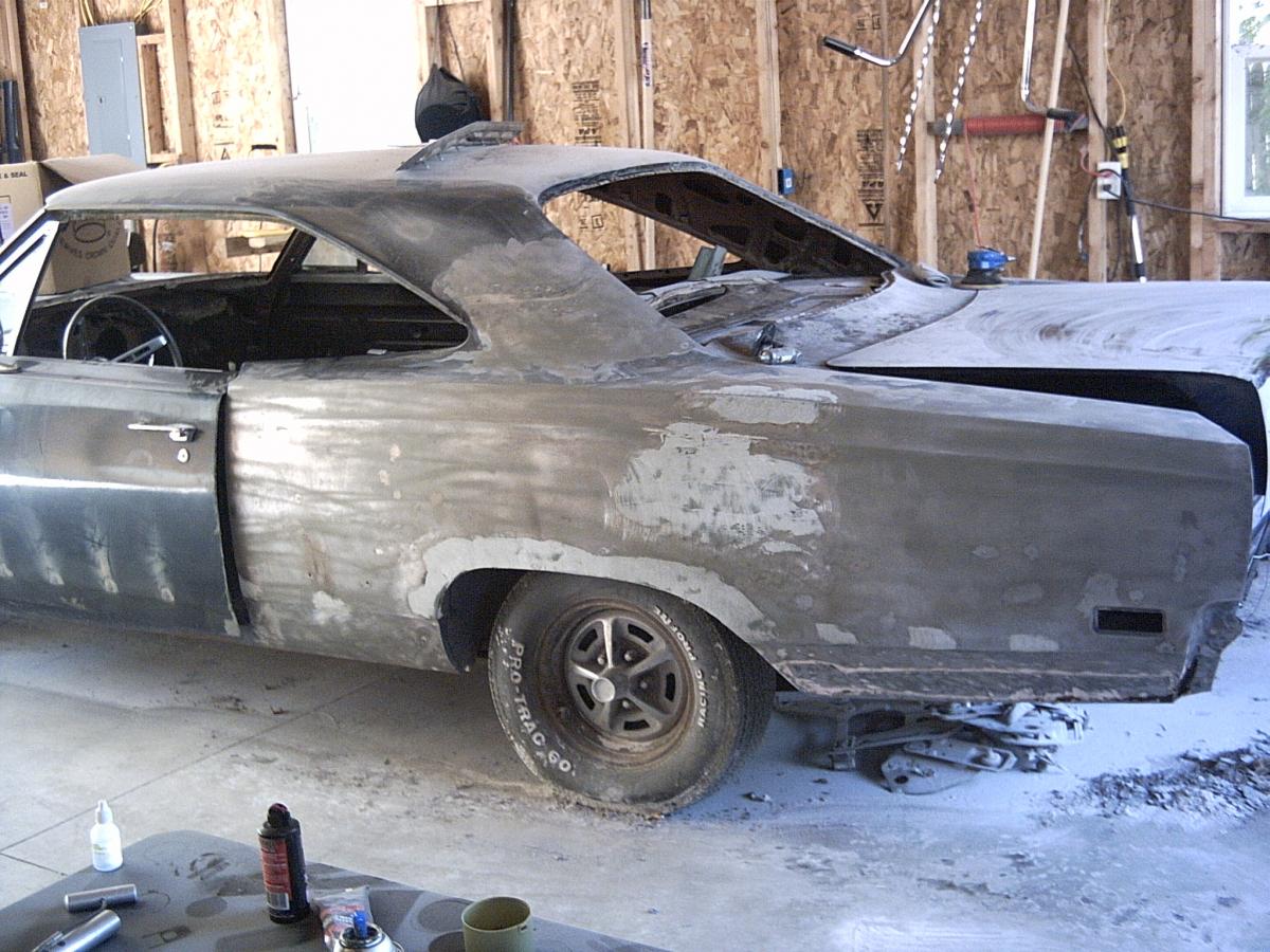

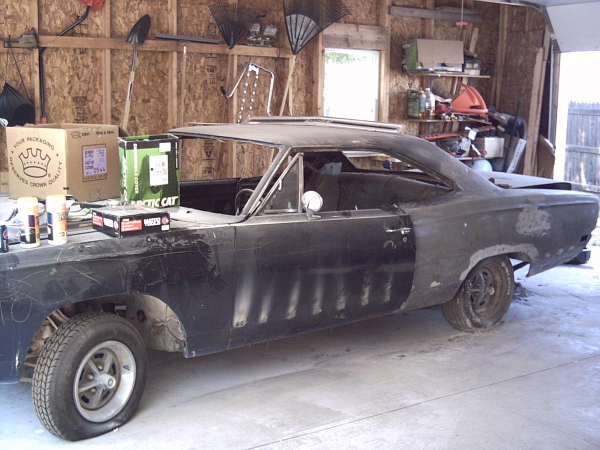

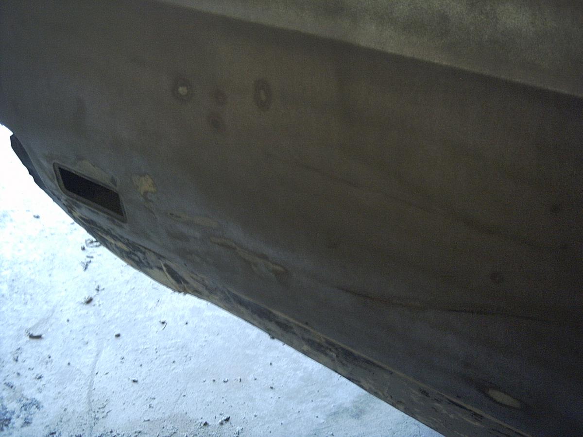

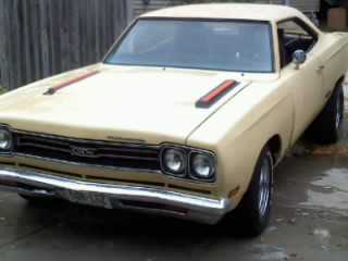

i am kicking my self because i didnt take enough pics along the way but here is the car i got about a year and a half ago. these pics are a few days after i got it and already started to strip it, notice how bow out the fender is and where it looks like the car went sideways into a poll in the rear quarter. oh and i forgot to mention someone else restored or repainted this car before

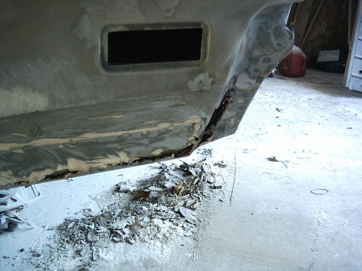

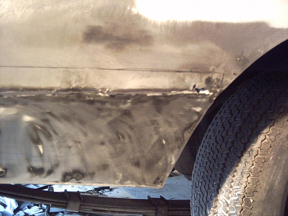

i dont have a pic but the rear window took me 3 hours to remove do to previous hack job repair of window sill, they basically took 2 in wide sheet metal bent it in half 90* and made a bunch of relief cuts to for it to the window shape, the problem is first they never took care of the old rust problem second they only welded it along the top edge leaving all those little relief flaps loose (thats what kept catching my window tool). the trunk center had been replaced and both sides the lower rear qaurters had patch panels in. now when i was taught body work i was told never go thicker than 1/4" with bondo if it had to be thicker use fiberglass first. i was also taught any time you have weld seams that you are covering use fiberglass not bondo, the quarter panels had at least 1/2" to 3/4" of bondo over them

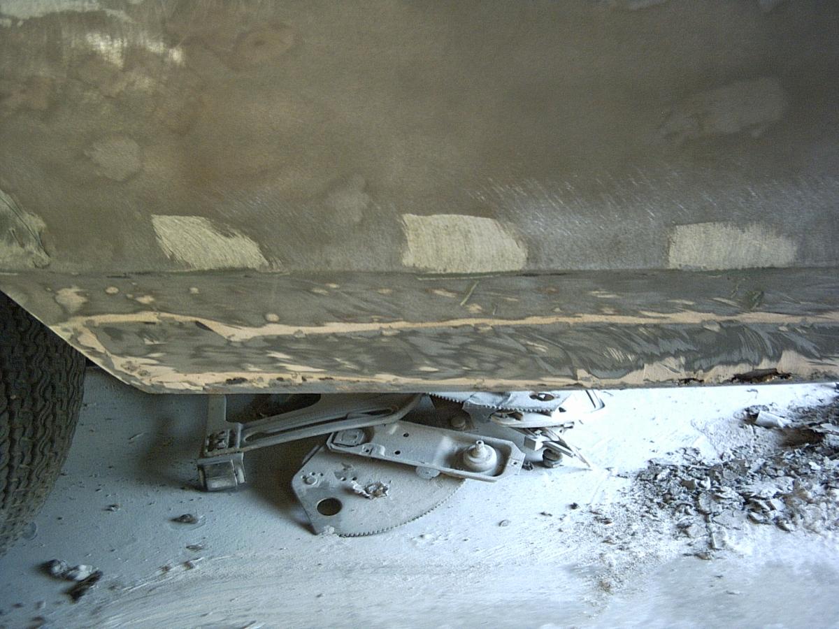

now i was 25 turning 26 as i got this and am now 27 and i do make decent money (make $22 an hour building military trucks for oshkosh corp) but still only middle class so i didnt have money to through at buying new metal even though it could have used it, instead me and my little brother (who is a profesional certified body tech)stripped the car and then spent a lot of time with hammers and dollys and a unispotter. we straightened everything to our best capability and started with our bodywork i hand fabricated new lower quarters to replace the previous patches and then i went to work completely redoing the rear window seat.

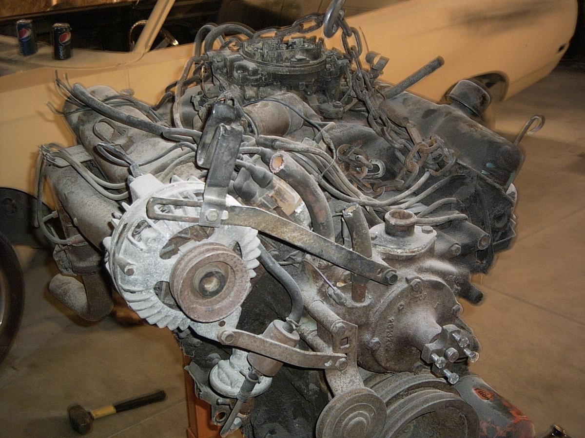

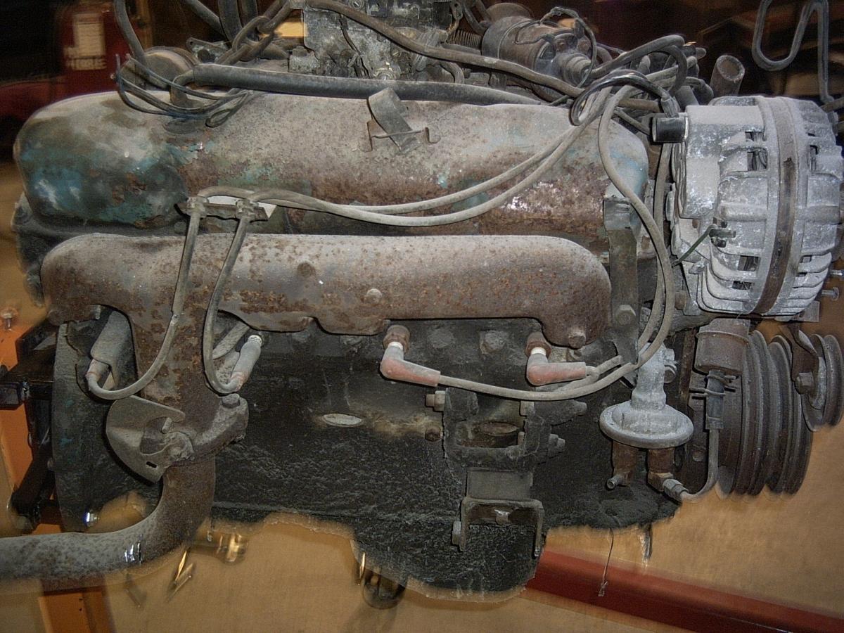

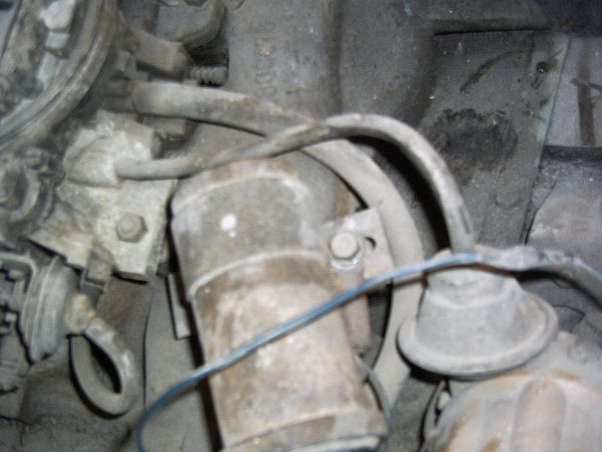

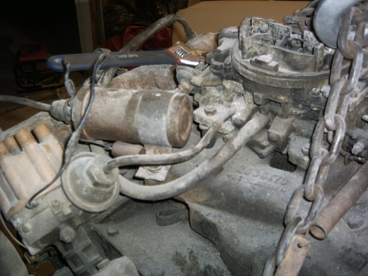

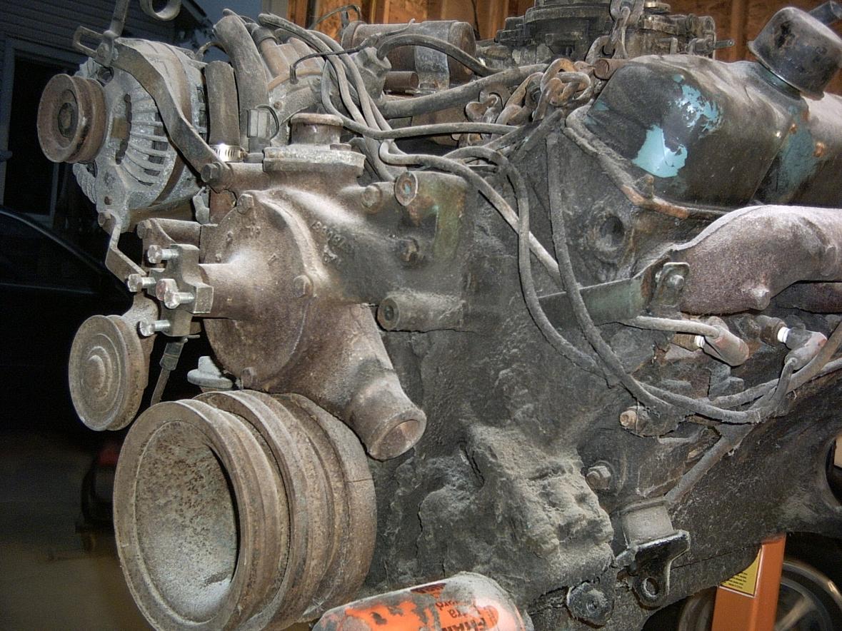

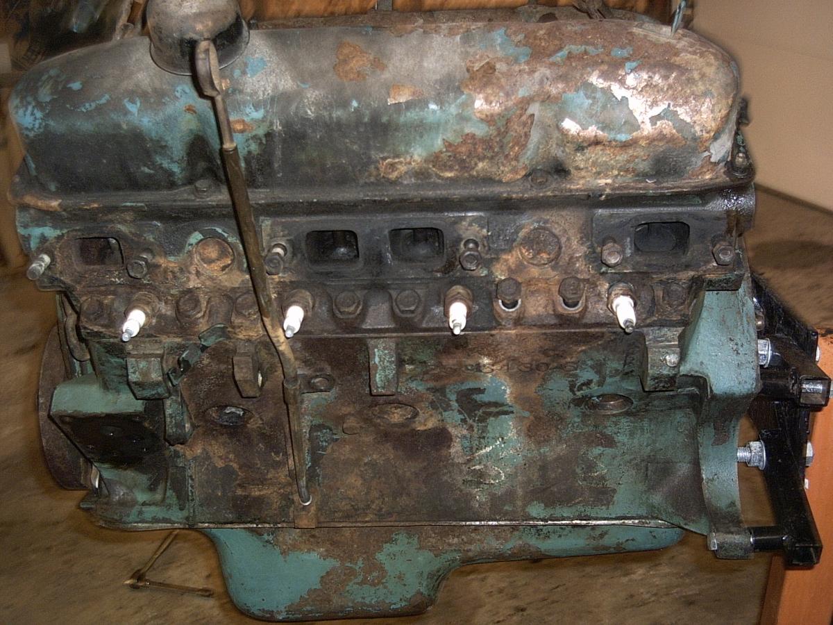

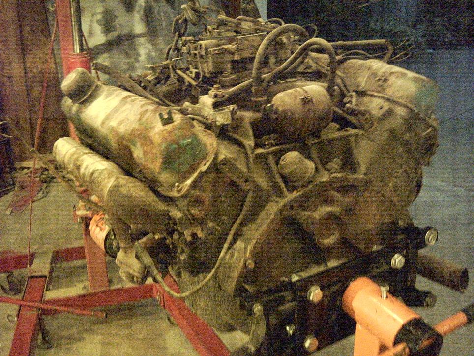

i was only able to work on it before work (2cnd shift) and on weekends by the end of the summer we had the car into rough primer (not perfect but close) i also cleaned my rust free under body and used an expensive spray on bedliner for the bottom of the car and i used a cheap walmart roll on bedliner in the entire interior of the car. i then decided to start on getting the car mobile. i was put in touch with a gentleman named larry from oconto wi for various parts i bought a used non hp 440 for 600 from him along with multiple other parts i was missing for reasonable prices

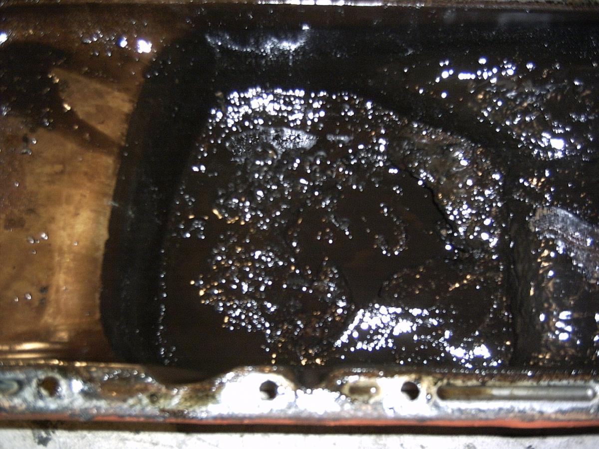

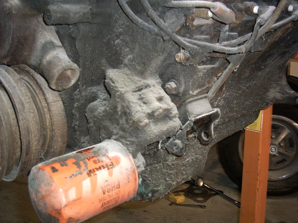

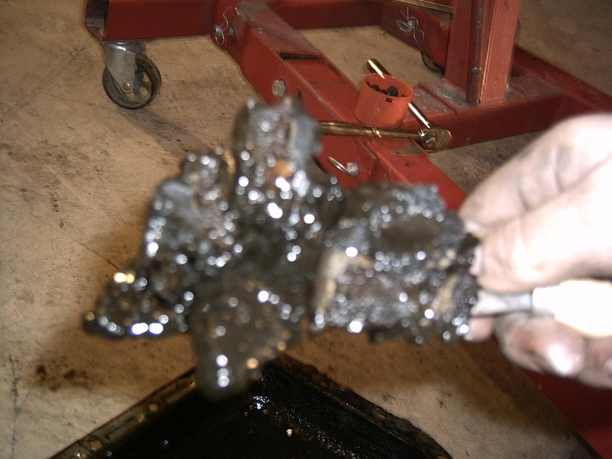

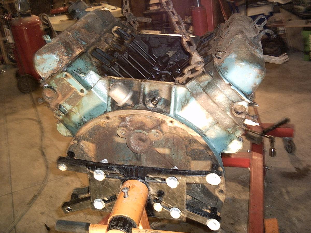

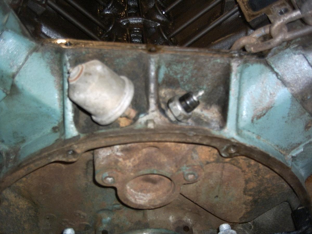

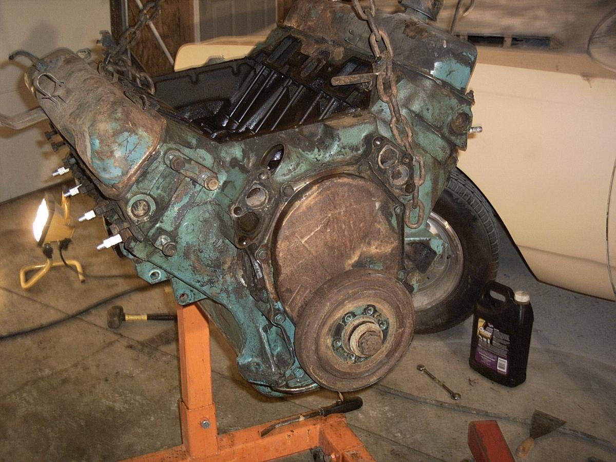

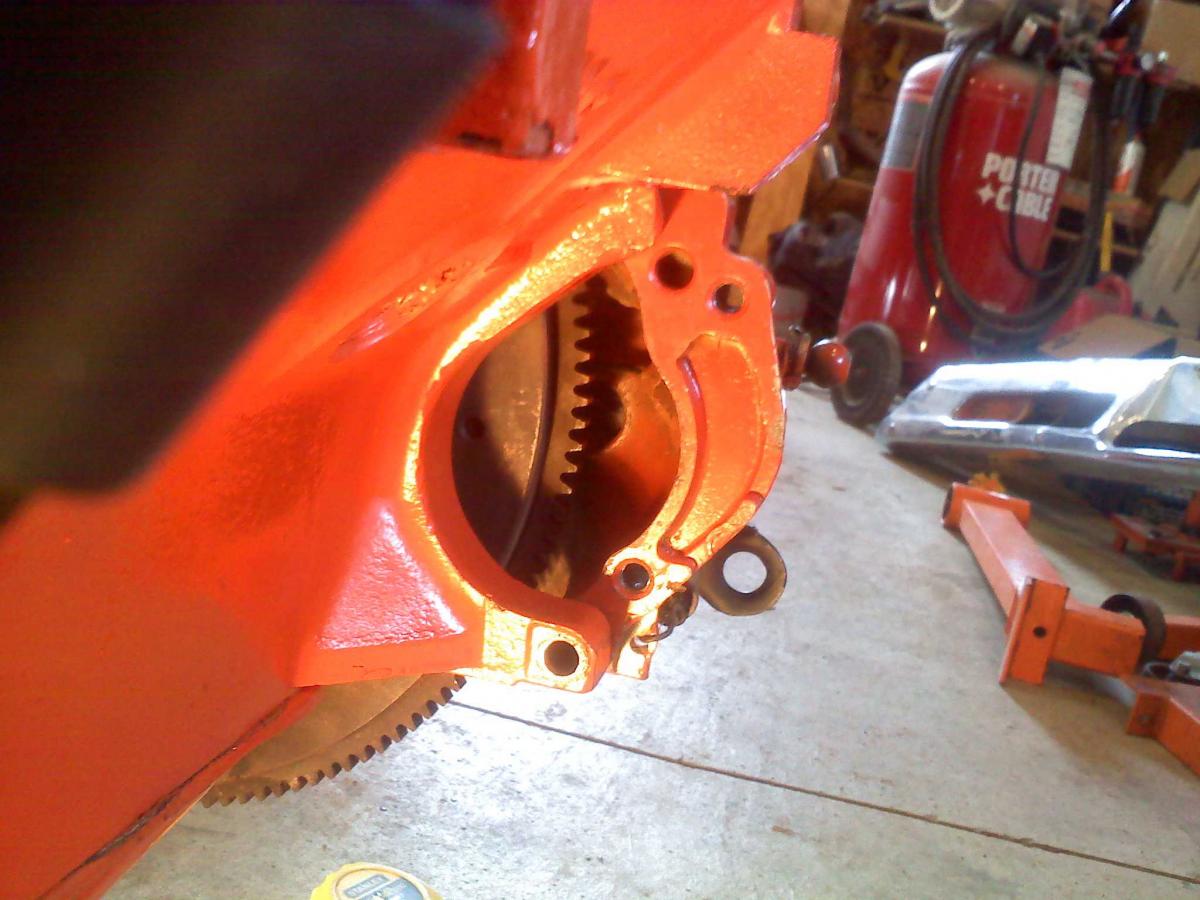

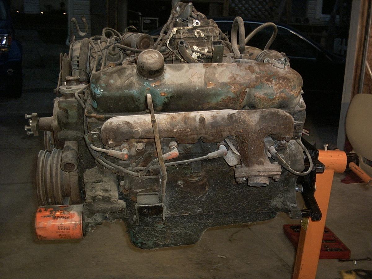

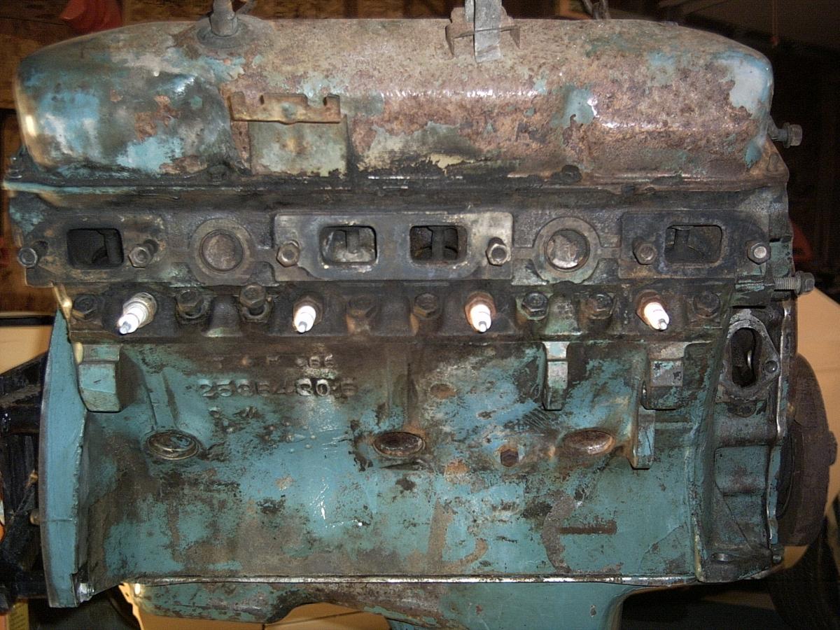

so with this engine i decided to rip it apart and put a new timing chain in and all new gaskets, clean it up paint it put a new fuel pump on it and rebuild the carb

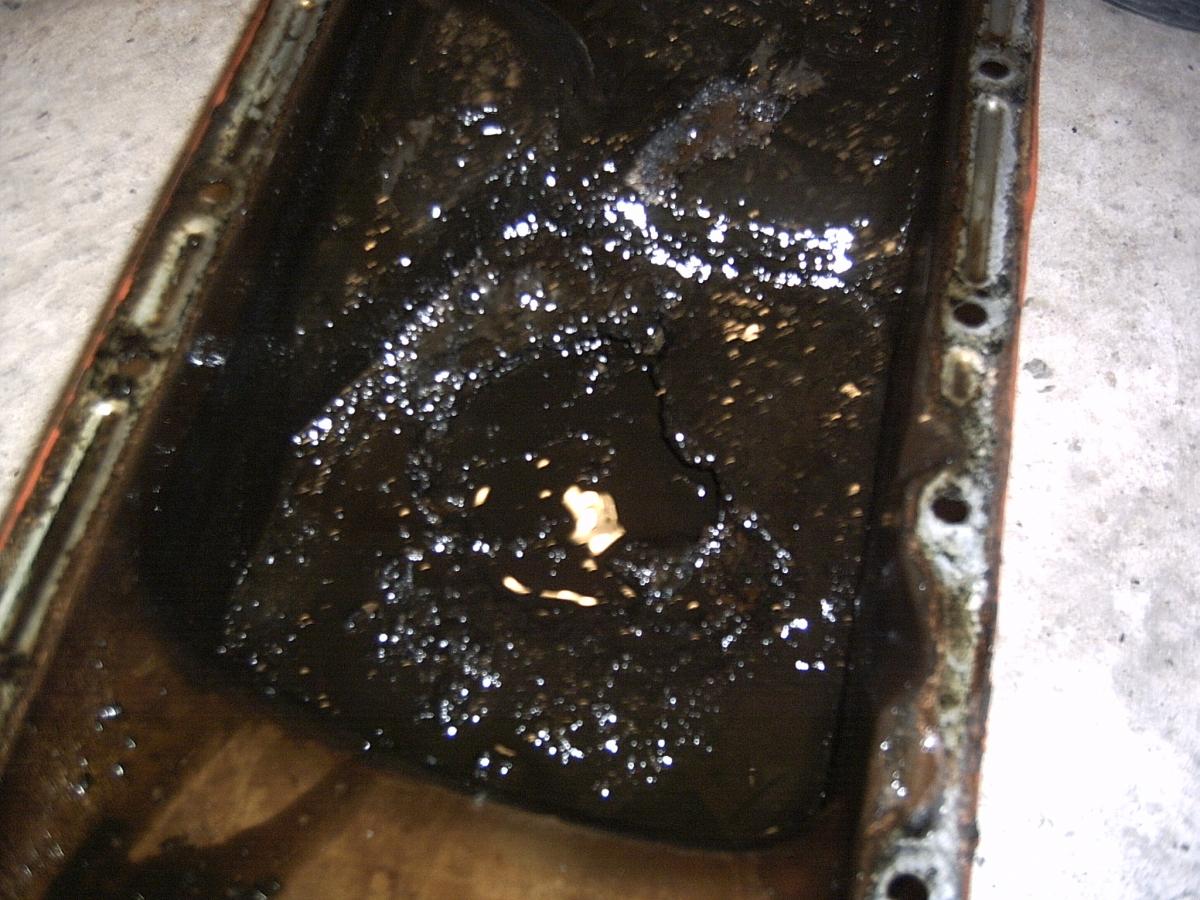

you can see how much oil sludge was in this engine

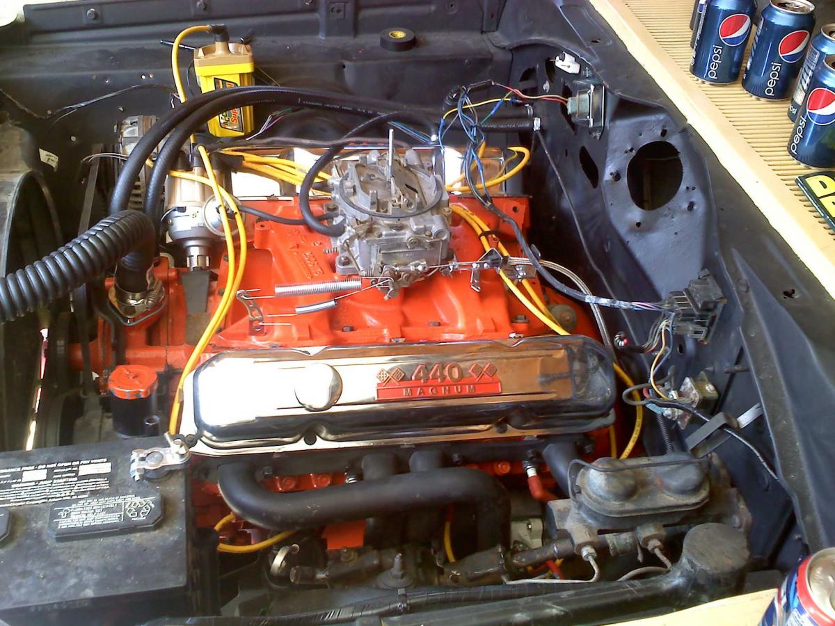

so i spent alot on new parts to get it running inc. stage 2 clutch kit, z-bar rebuild kit, accel super coil, summit racing headers, a used ebay mopar performance electronic ignition, new fuel pump rebuilt carb new timing chain set, got a drive shaft from larry along with even up exchange of my 10 1/2" aluminum bell housing for an 11" steel one. i also had to buy those little straps that hold the drive shaft to the rear end which is an 8 3/4. the wiring was all just thrown into a box nothing labeled so i bought one of those wiring diagrams off ebay (that was a great help).

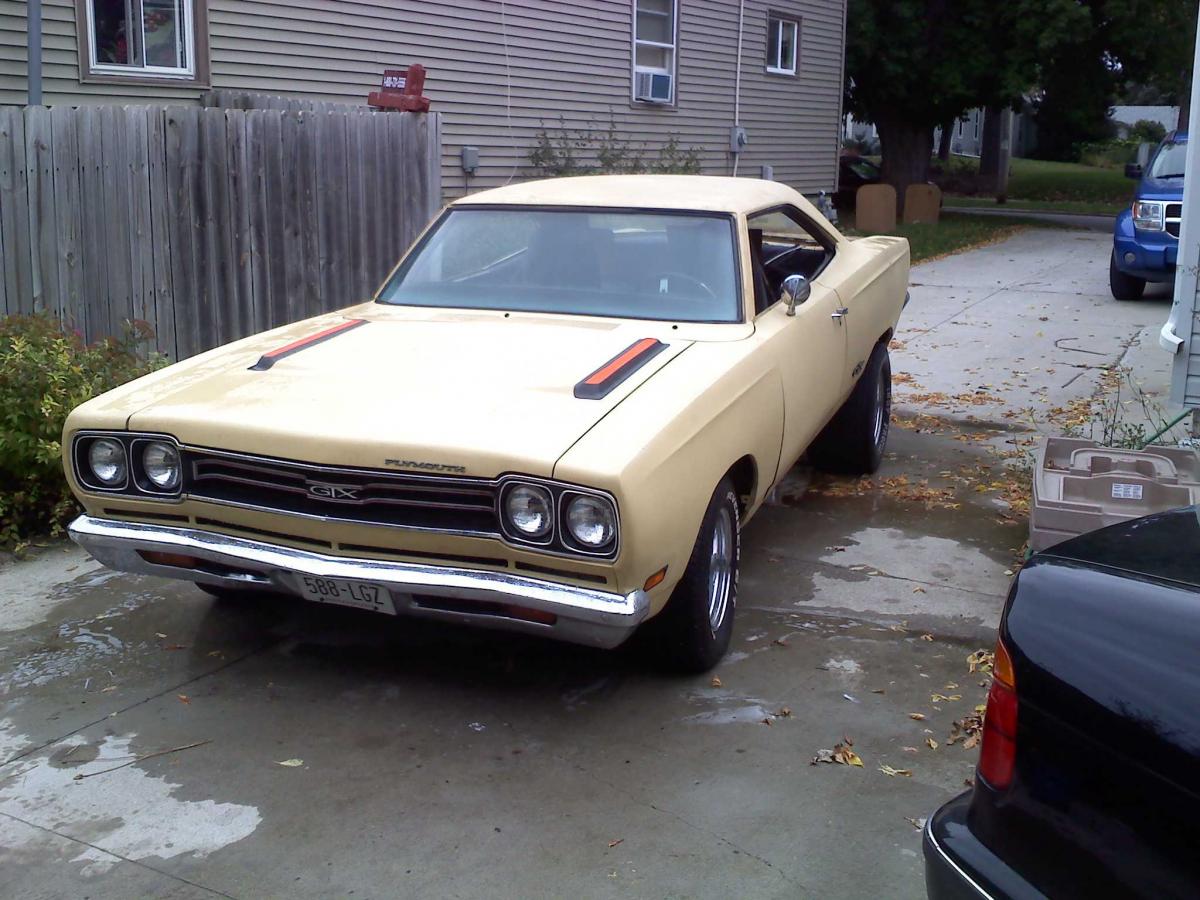

i got it running together and semi driveable by october just in time to park it in my nearby storage unit for the winter
oh and i cant forget i got a great deal on rims and tires last summer as well rims are used american racing front tires are i think 235 60 15 not sure though and the rears are mickey thompson n50 indy profiles all have good tread on them and i got them all for $250

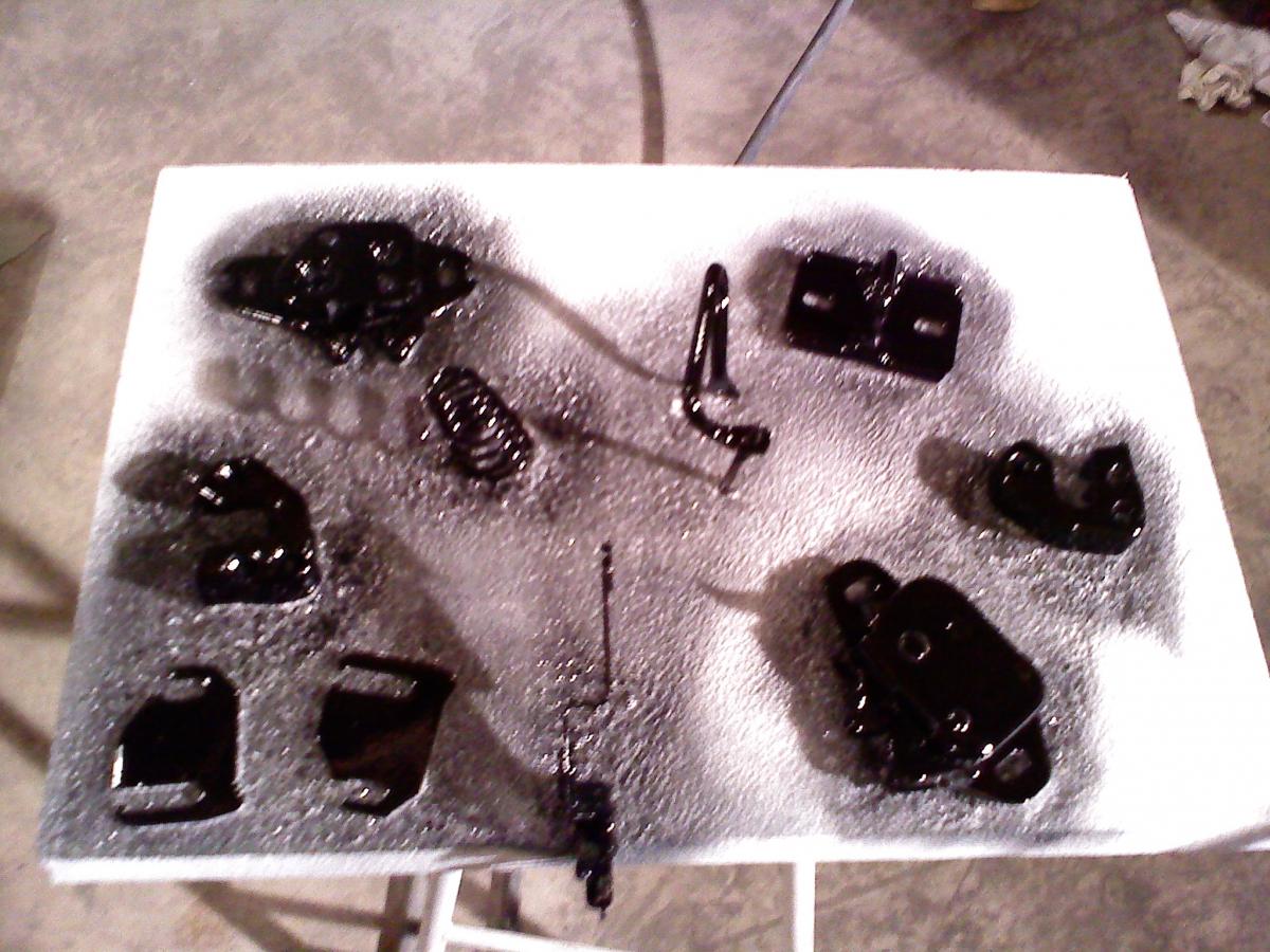

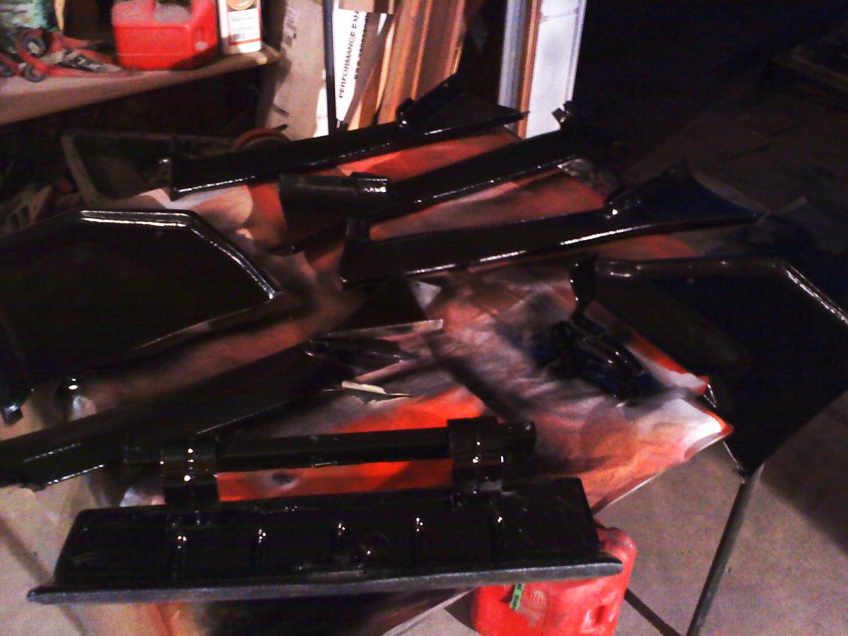

anyway so end of april i brought my car back and got back to work on it. my father is currently the body shop manager of a shop in waupaca wi and he told me that he can arrange it so when im ready to paint the car i can use the shop's spray booth. so ive been working on jambing out the entire car so i can just paint the exterior at that shop. earlier this year i bought some off my paint through my father unfortunately it is that new water bourne paint, this paint is extremely picky and is not useable out of your garage. even my father has complained about this paint with their expensive filtration system in fact last week they decided that they are going back to urethane and that is what i'll be using on my car (thank god)

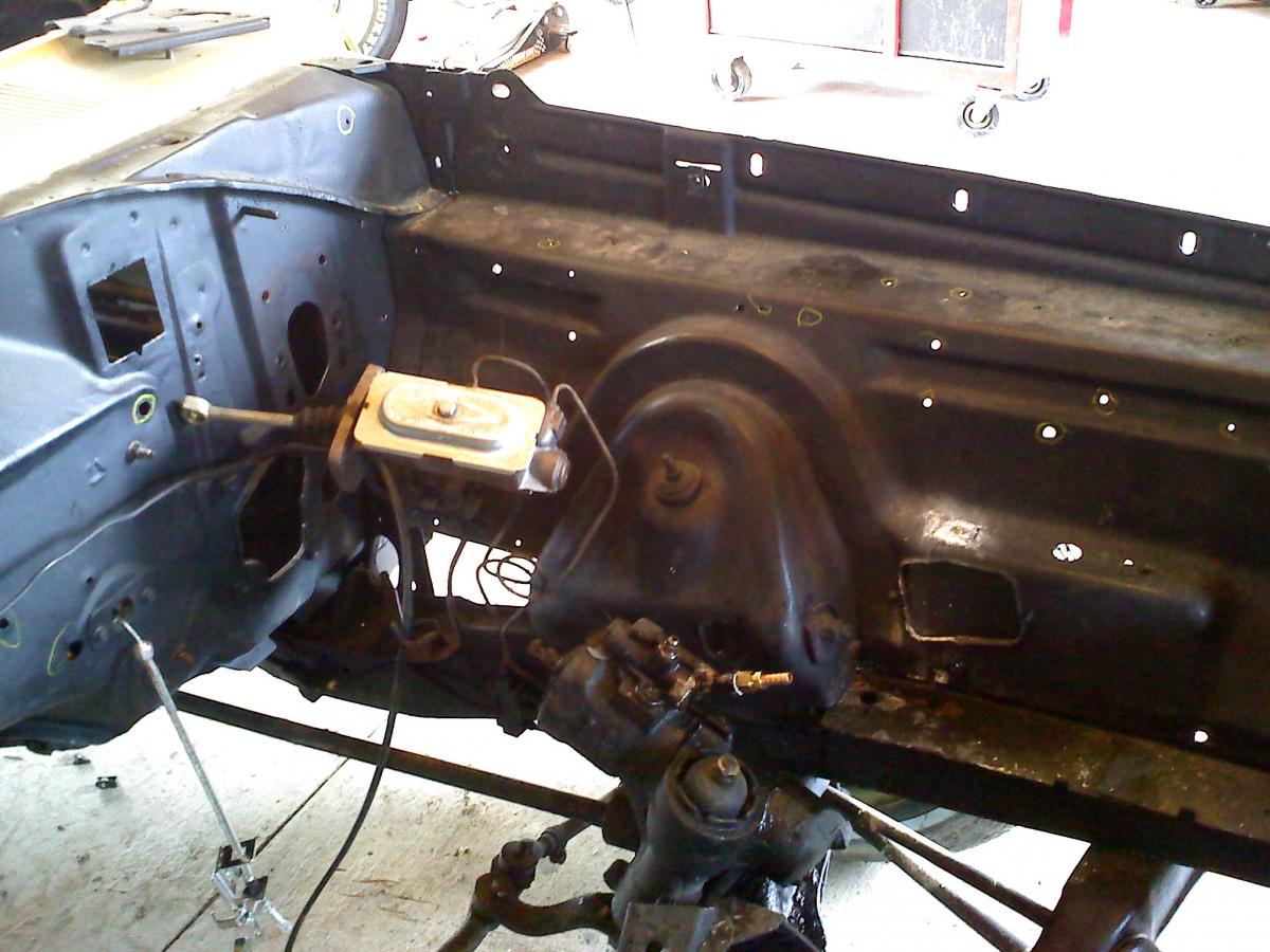

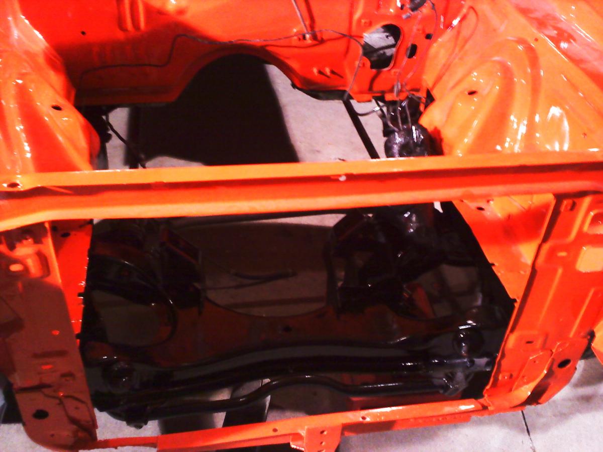

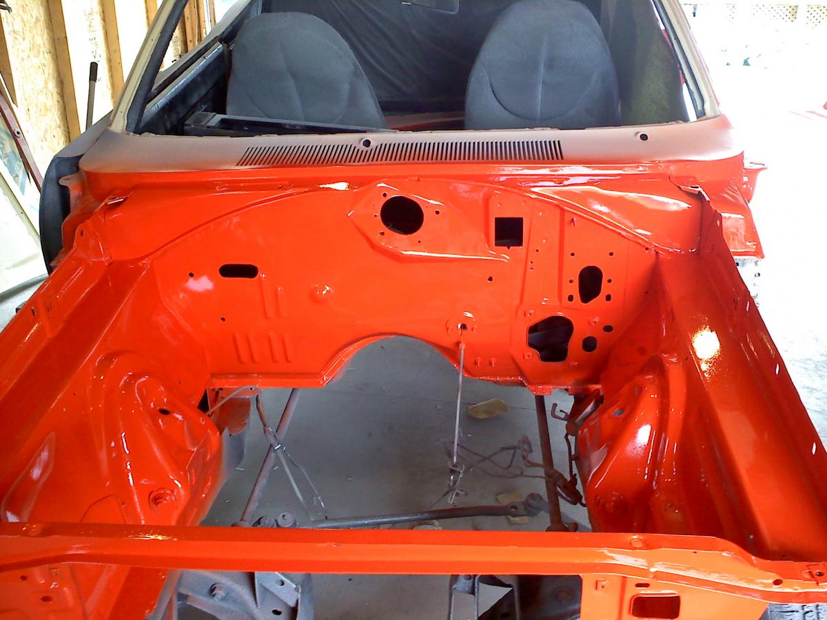

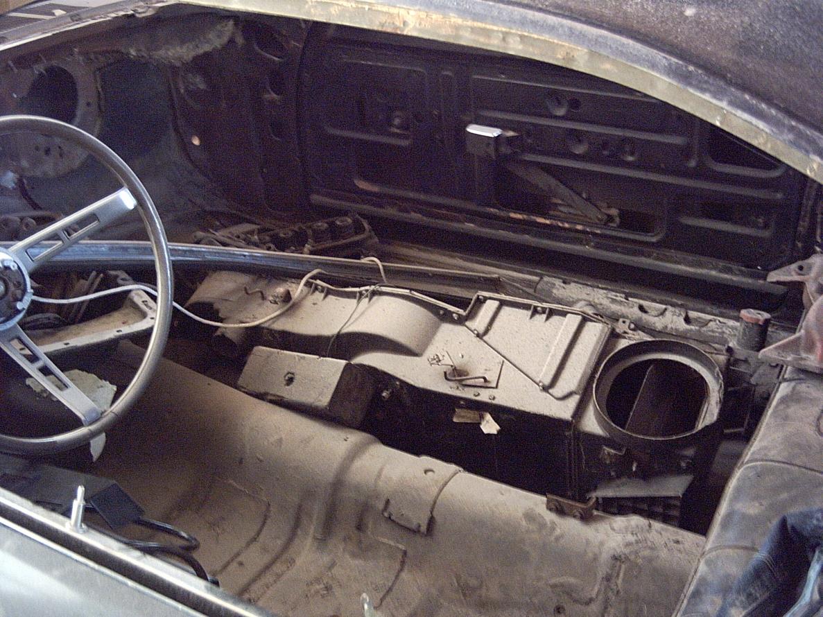

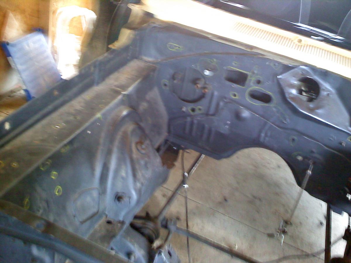

as i stated earlier the wrong heater box came cobbled into my car, my car is supposed to be an ac car but i got a non ac heater box. i dont ever plan on putting ac in so i decided to clean up my engine bay and weld shut all my random holes through out the engine bay (they are circled in yellow)

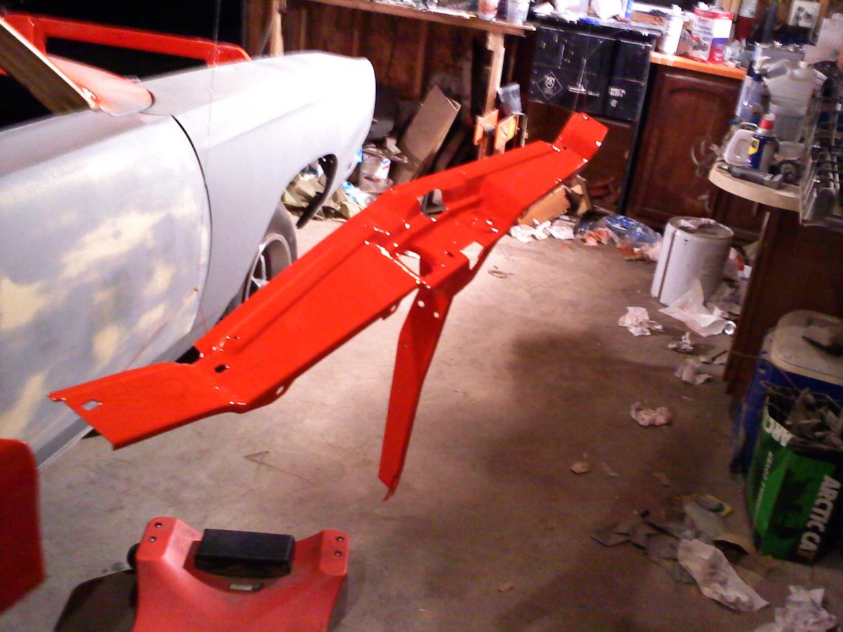

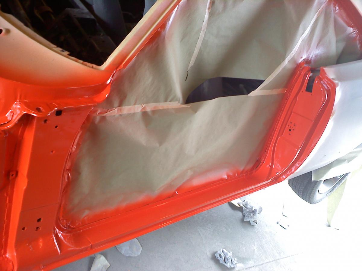

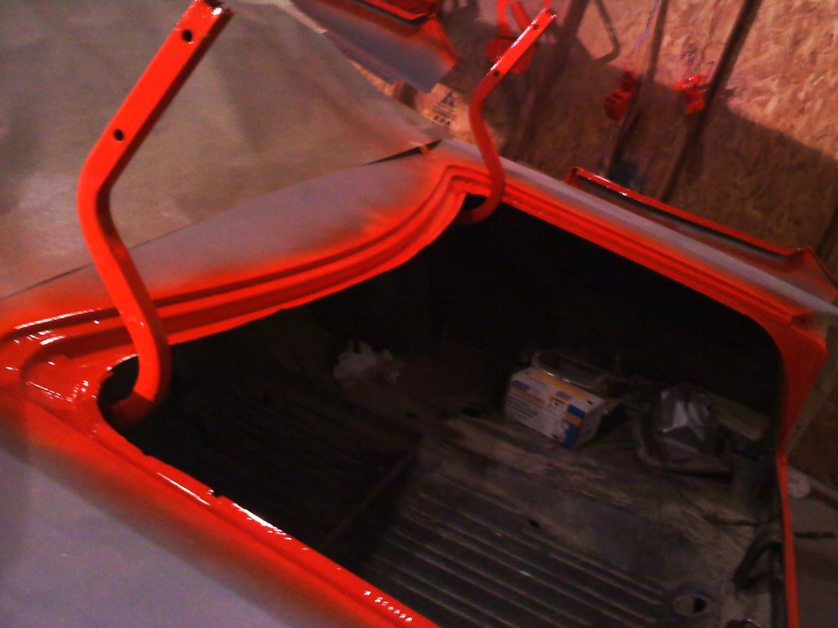

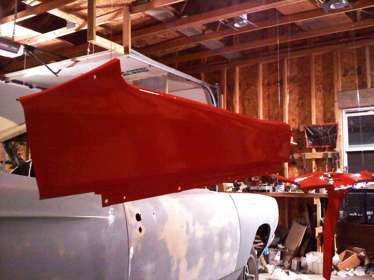

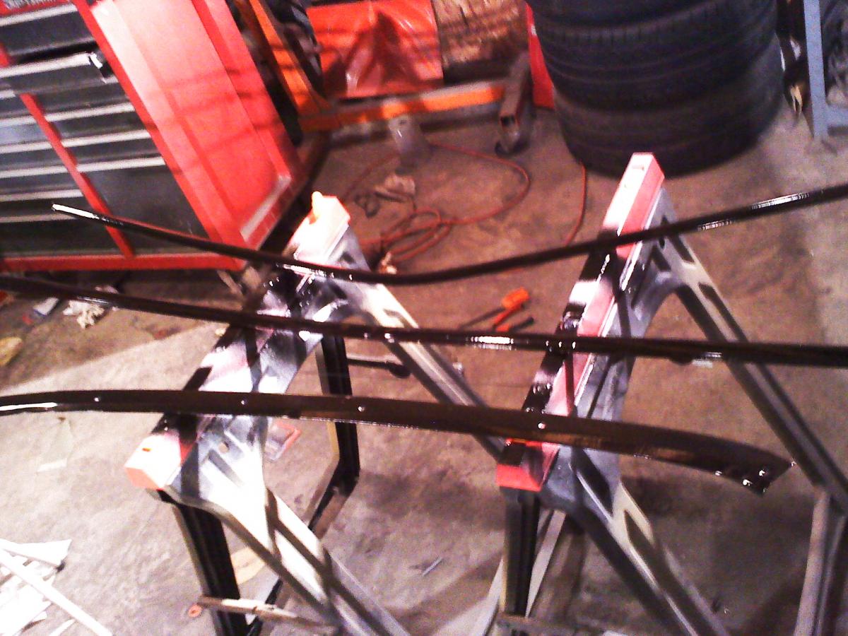

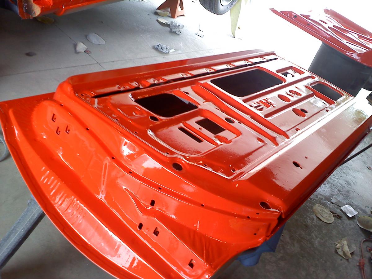

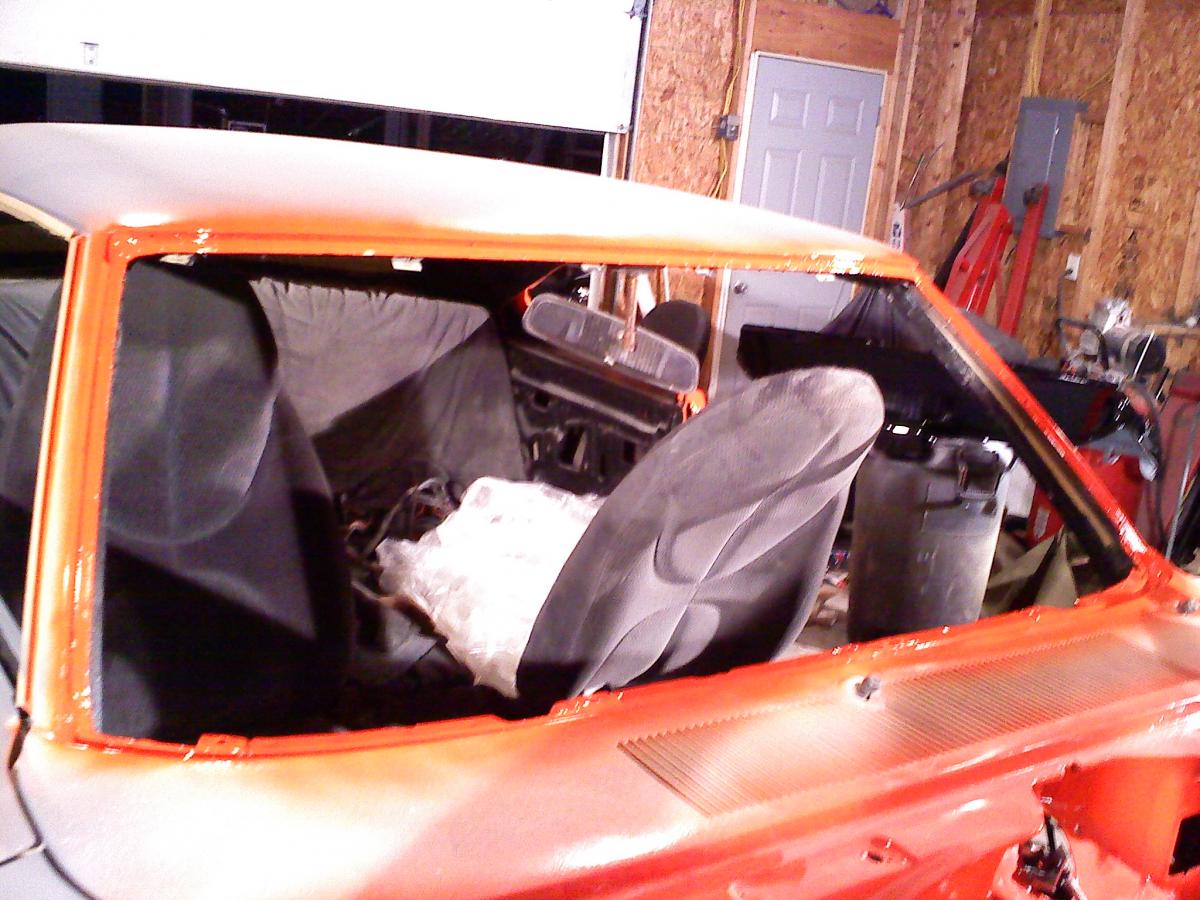

now i currently have the drivers side in final prime and jambed the trunk is jambed deck lid top in final prime bottom is painted roof is in final prime, hood needs finishing body work and final prime pass side needs to be blocked a little better then it will be final primed and ill then be able to paint the pass side jambs

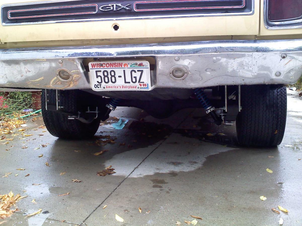

well my computer crashed last week so i havent been able to post for a while but 2 weekends ago i finished spraying the rest of the jambs and last weekend i put it all back together and got to put the first real miles on it since ive owned it and of course i got to find more problems (tranny now leaks, rear end leaks at input shaft and by both wheel hubs, and my entire power steering system is junk, the gear box leaks and the pump also went out on me) but on the plus side my front brakes release now with the new disc brake master cylinder and my new one wire alt from summit seems to work great as well allthough being chrome plated i did have to get the belt a lot tighter in order for it not to squeel compared to regular style
