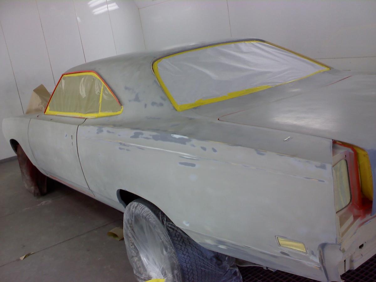

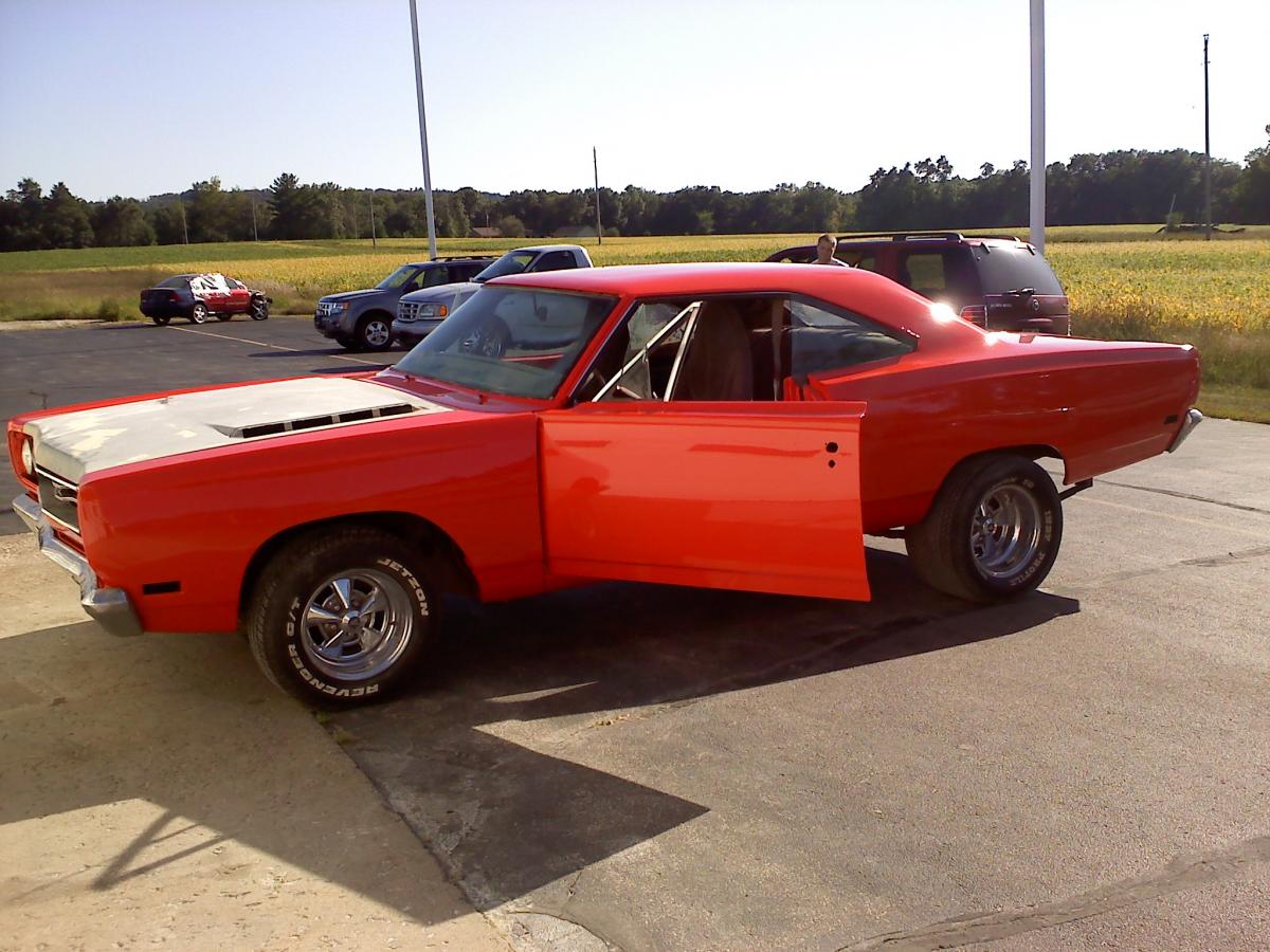

well i know its been a while since last update but things weren't proceeding like i wanted but now finally after this weekend i have the body nice and straight and painted. i still need to do something with the hood yet (my old man wants me to junk it and buy a new one but with shipping that would be around $700 that i dont have right now). now i at least have some color but not sure how long before finished color. here are a few pics right before paint and after paint
Awesome! Looks sweet Morbid! Man I wish I was that far a long. That color works out great on the GTX. I'm gonna have to look you or your Dad up when it comes time to paint mine.
thanks but shes not done yet i still need to do something about the hood. oh ya by the way this is straight out of the booth. it has not been buffed yet
Will, as for painting yours i personally only painted all the jambs and the backs of the doors and deck lid and the smaller bolt on parts. the body i was a little worried that i would run the clear so i had my father and younger brother spray them. i probably could spray it decent but i would rather you go to my father when the time comes

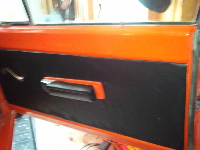

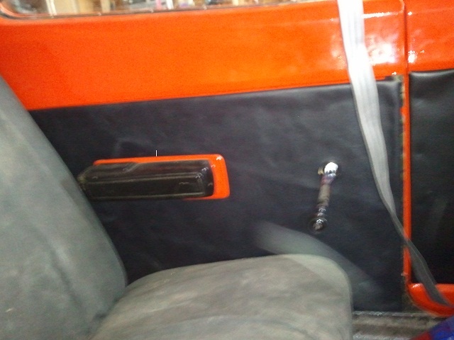

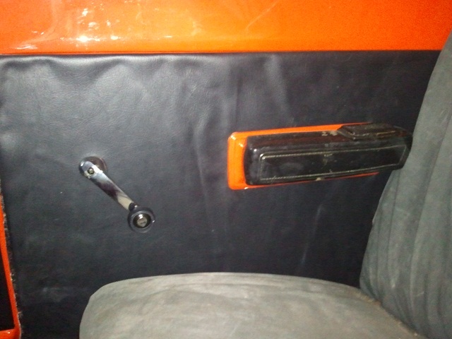

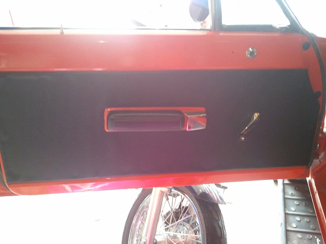

now that we got our pics working again i can finally post my homemade door panels granted they are nothing over the top or even anything like the originals but the $80 i spent on making these is a whole lot less than buying them from someone like legendary

that looks like the same kind of fabric(for lack of a better word) that i was thinking of doing some interior work in my RR.that looks pretty good so now i know how mine will look.thanks for showing.how did you attach it to the cardboard panel? spray on glue or something else?
Spray on contact adhesive would be the way to go. 3m makes some good stuff that places like Home Depot carry. Does look good Jason!
thanks i used a 3m neoprene glue that i got from work its a red and white tube with the number 1300 on it. that stuff is very very sticky try not to get it on your hands
the end result might not be good,especially if you went to the blue room right after using the stuff.
