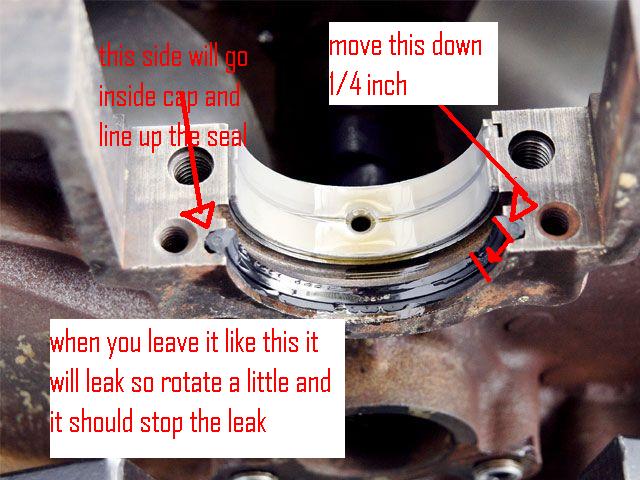

i had a 440 with the same problem you have to rotate the seal past where the 2 haves meet on the block it helps line up the ends because of the play in the endcap bolt holes

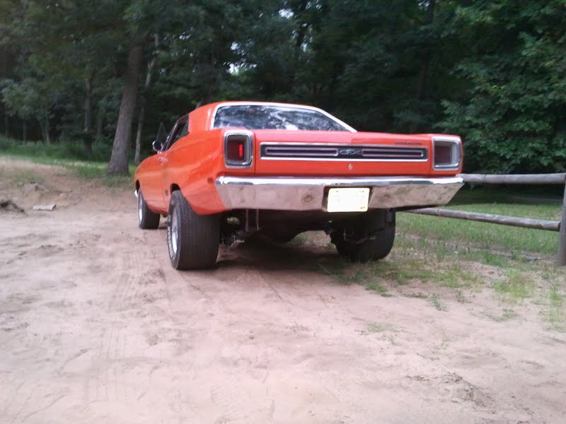

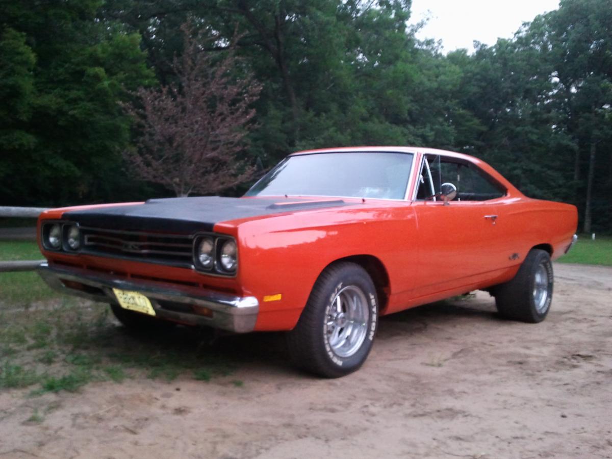

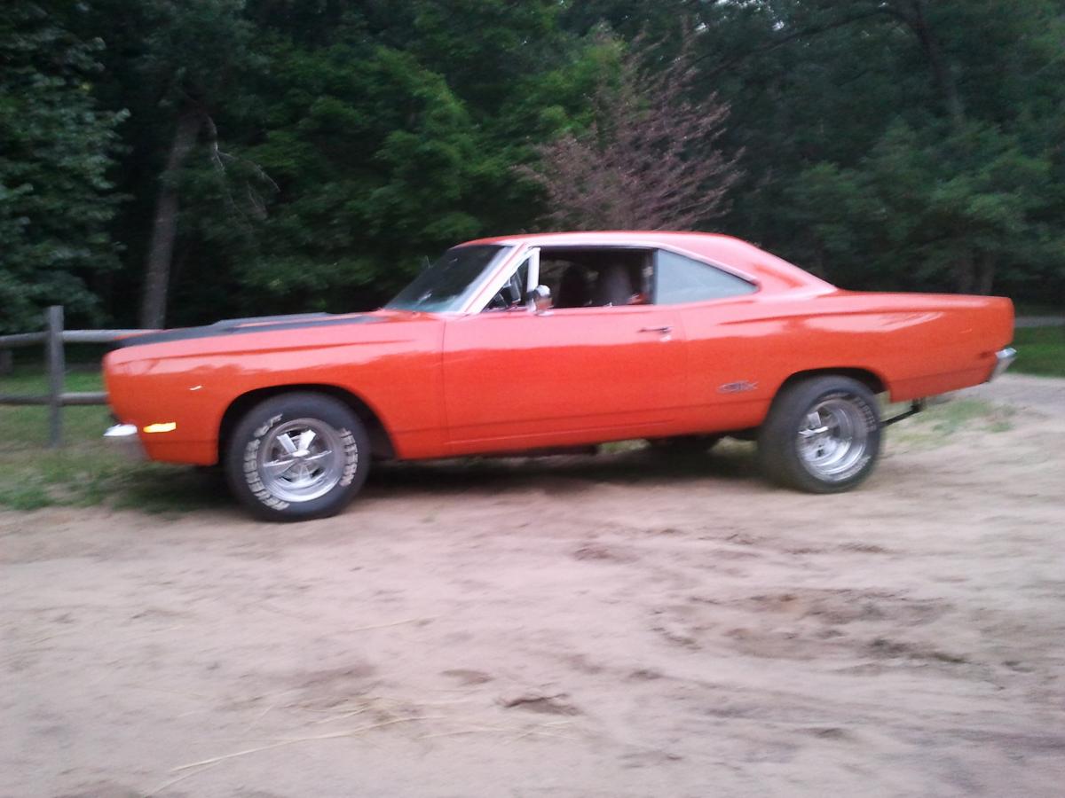

here is some newer pics, picture quality isnt the best i took them on my phone but my phone is acting up and wont let me link to my comp so i had to email from my phone to myself which caused me to loose picture quality
