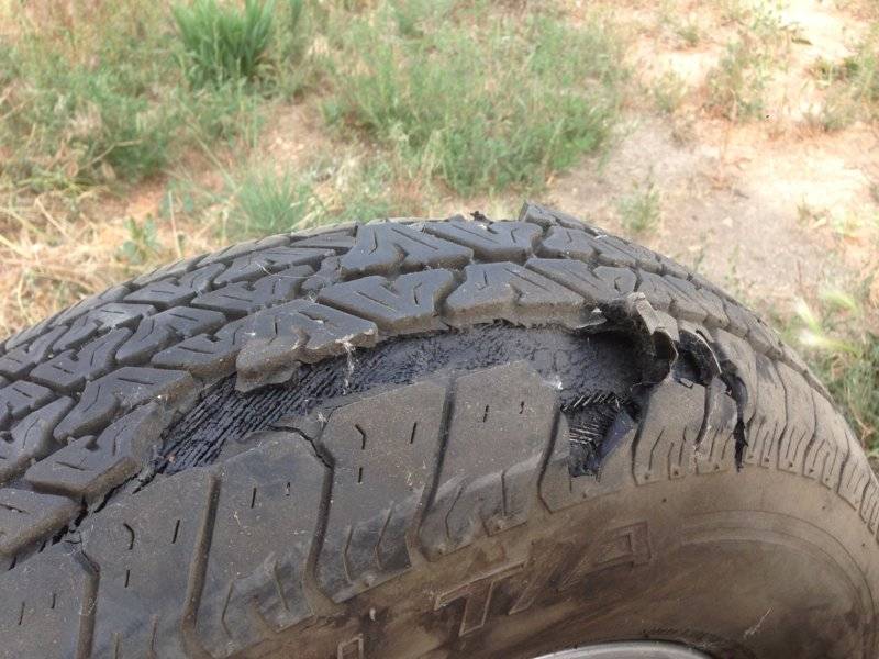

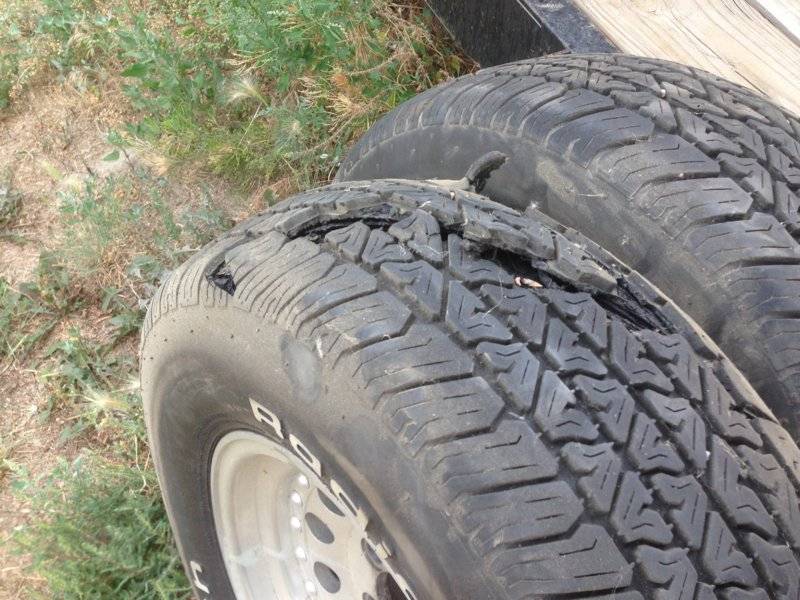

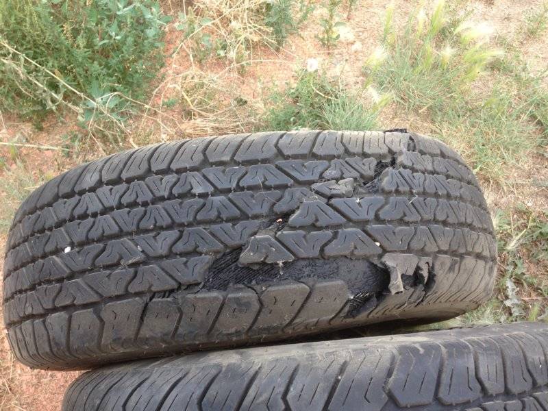

and wondered why it did that. Well, I bought a set of rims with rubber a couple years back. They were all good but one. It had a bulge. It was no worry to me, I bought them for the rims. I proceeded to put them away with the masses. So they have been in my storage shed for a couple years. Today I decided to dig around and see what rims I have that would fit things. Well, I found this! This is a BFG Radial TA. It is literally separated at the seams. And believe it or not, it still is holding full pressure! If you see a bulge and wonder why it did that and if it's bad.........it's really bad!

View attachment 639009 View attachment 639010 View attachment 639011

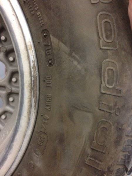

Just for curiosity, how old was the tire?
They are old for sure. I could look. But the point is still the bulge. It was bulged before I got it. If they are new and bulged i would think it's no different than than 29 years old and bulged. They are dangerous regardless. I was just surprised by what happened sitting in storage.
Is this the date code?
There is a very good reason that "date codes" are on tires.--Age matters.
I am in now way saying age doesn't matter. I'm saying a bulge is bad regardless of age.
Duh--sorry to perhaps seem abrupt.
The tire we view in this thread has clearly failed.
We all have no clue about its life and what it felt before it had its aneurysm.
The main reason I posted this isn't for all you antique human beings like myself! Who were fixing cars at the age of 13. This is for those who are much younger than us, were raised in a city, by a single Mom, who never owned a crescent wrench, who never changed a tire before they got the classic they are tinkering with now. Or for those who just wouldn't think that this stuff happens. :)
usually happens from an impact , ie potholes and other **** in the road ..... once there is a bubble consider it done, it'll only get worse !
This is a big key to this topic. A tire can receive big damage and keep on rolling. Sometimes for years.
the date code is the last 4 digits of the DOT number. Should read something like 1618

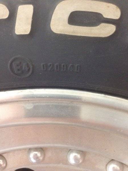

Those sure are old, that date code is February 9, 1940...
