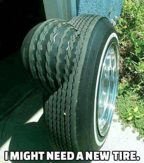

Just an F.Y.I. If you ever had a bulge in a tire.......
This is a BFG Radial TA. It is literally separated at the seams. And believe it or not, it still is holding full pressure!
View attachment 639009 View attachment 639010 View attachment 639011
Greetings gdrill! This BFG tire has separated and can be warranted if the tire is less than 6 years old or within 6 years from date of purchase.
https://www.bfgoodrichtires.com/Tire-Warranty.page
All tires never stop the curing process. The rapid curing happens at the factory under heat and pressure. But afterward, continuing to slow cure with time the tire will stiffen, crack and fail. My belief as a consumer is a 6 year warranty cut-off is kinda/sorta chickenshit. Back in the day, there were no time limits for warranty defects due to tire age. I believe a 10 year old tire on my daily driver would be pushing it unless that tire was once a spare in the trunk. Even then I would monitor that tire for any cracking on a consistent basis once it is on the ground.

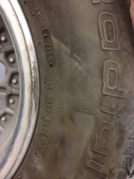

If the tire date code was deciphered correctly, the tire(s) in question are 19 years old.
Ya know, I read that "1999" and thought, "Oh, that's not old." Until you told me. Damn.
I looked and did not find a bulge on any of my tires but i did find one in my pants.
49th week of 9. Pre 2000 tires are all 3 digits. Meaning it could be 89. Not sure when date codes started but I think 79 BFGs looked a little different.
2499 would be 24th week of 2099 at this point.
For tires manufactured before the year 2000
The date of manufacture is the last three digits of the code. The first two digits refer to the week within that year. For example, if the last 3 digits are 022, it means that the tire was manufactured in the second week of the year, and the year is the second year of the decade. This is where it gets confusing -- there's no universal identifier that signifies which decade, so in this example the tire could have been manufactured in 1982 or 1992. Some tires do have a small triangle following the DOT code to indicate the 1990s.
