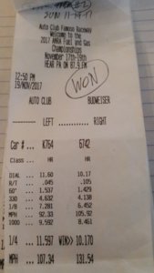

Here is a pix of one of my recent timeslips:
You said your 1/8 ET's and mph were 6.49 and 6.47 @104.xx mph..
For your comparisons
my
Quarter Mile 10.17 @ 131.54mph shows 1/8 mile @ 6.45 @105.92 mph. (My best 1/8 mile ET and mph are 6.448@106.07)
