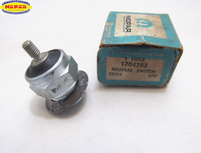

My 64 Bristol 408 has a 1962 727 push-button transmission. It starts just fine in reverse or drive - ask me how I know!
I haven't crawled around to see if it's just a loose wire on the neutral safety switch, or what, yet but I have managed to get confused over whether it should have a single wire connector or or 3. The notes I have from the previous owner say the transmission serial is 2400157 022398. I am thinking it will be the single connector one. Is anybody able to confirm and provide the part number, please?

A 62 should have the single threaded stud but I can't tell you the PN.
Mike
Loose wire would be a no start.. The wire gets grounded to complete the circuit... The circuit receives 12v front the ignition switch when it the start position.. That 12v energizes the coil of the starter relay... The NSS provides the ground path for the relay coil... When the coil has ground and power it closes the relay contacts connecting the battery to the starter... Sounds like either your NSS is internally shorted or the wire from the NSS to the relay is shorted to ground....

In that case, I think you have a cable adjustment problem. I have a cable-shifted Torqueflight in my 1964 Polara. I have the service manual for this car and it has a section on cable adjustment in it. You could pull your pan off, and with pushbutton in neutral, turn the cable adjustment wheel until the tang on the rooster comb is contacting the neutral start switch.
The factory manual actually has a procedure that doesn't require removing the pan... But it requires the NSS to be working...
You hook a ohm meter up to the NSS and ground... Remove the bolt that attaches the cable adjuster wheel to the trans case...
Trans in park or neutral... (On a early car it's the exact same place) Now back the adjuster wheel off (Counterclockwise) a couple turns... Watch the meter while pushing inward on the cable and start screwing the adjuster wheel clockwise till the meter shows continuity... From there continue turning but count the bolt holes that pass till the meter shows a loss on continuity... Split the number of bolt holes in half, back the adjuster off that amount & bolt it down... Your done...
If it is the NSS make sure you buy the correct one as there are 2 different single wire ones.
The difference in the single pin switch's. Plastic plunger fits 65 and up and 64 console shift. Steel plunger fits 62-64 they set in the case at different depths.
