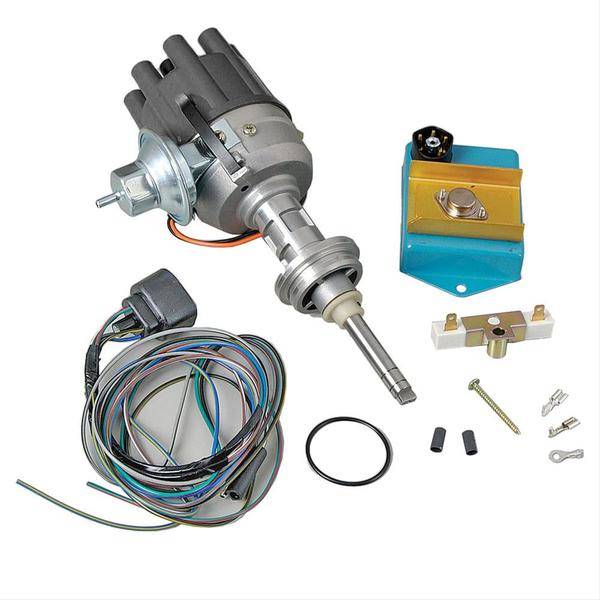

I just installed a SUM-850005 electronic ignition kit in my '70 RR 440+6. I can't seem to get rid of a slight ping when accelerating hard, when I set my timing anywhere below 10btd the car runs like crap, seems to run well at around 12-15btd but get a slight ping when I hit it. Any ideas would be appreciated. Thanks

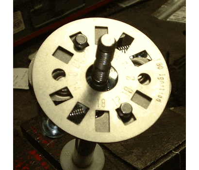

What is the total advance curve of your distributor? If you have a stock distributor they are usually around 25 degrees mechanical so that puts you at 40 total degrees timing when your at 15btd at idle. Are you using a timing light to set the total timing as well? You need to recurve the distributor so it will let you run 15 degrees or so at idle but total stays at 34-36. That can be done if you have an adjustable distributor or if you have a stocker, you can use the FBO limiter plate which works well or file the slots which is kind of a lost art and time consuming. I run the plate on my 360 in my PowerWagon and it works very well and is simple to install.

Here's the kit

I am with him.....running points isn't your issue at all. If anything going back to points is going backwards unless your looking for a 100% correct resto. It is all in the distributor. The timing plate must be adjusted to limit the total curve, giving you the ability to keep your initial timing higher while limiting the total timing.

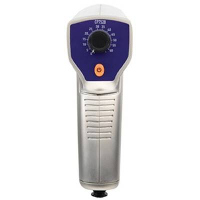

That plate I sent you a pic of can be added to any Electronic Chrysler distributor. If you have a timing light with a dial setting on it, you can dial in the timing you want total and use the zero marker on the balancer. That is what I do. Without knowing your timing numbers, you are basically guessing and without getting lucky you'll be out of the ballpark. Something like this light is worth its weight in gold!

Thanks for the great feedback, I just purchased an adjustable timing light (amazon), I will check the adjustability of this distributor, if needed the limiter plate seems like a likely option, I see Mancini sells these.
