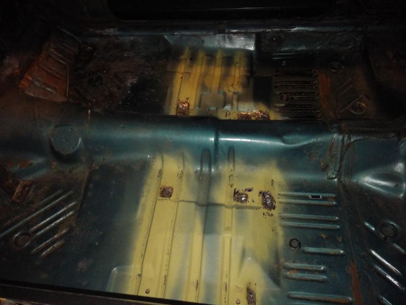

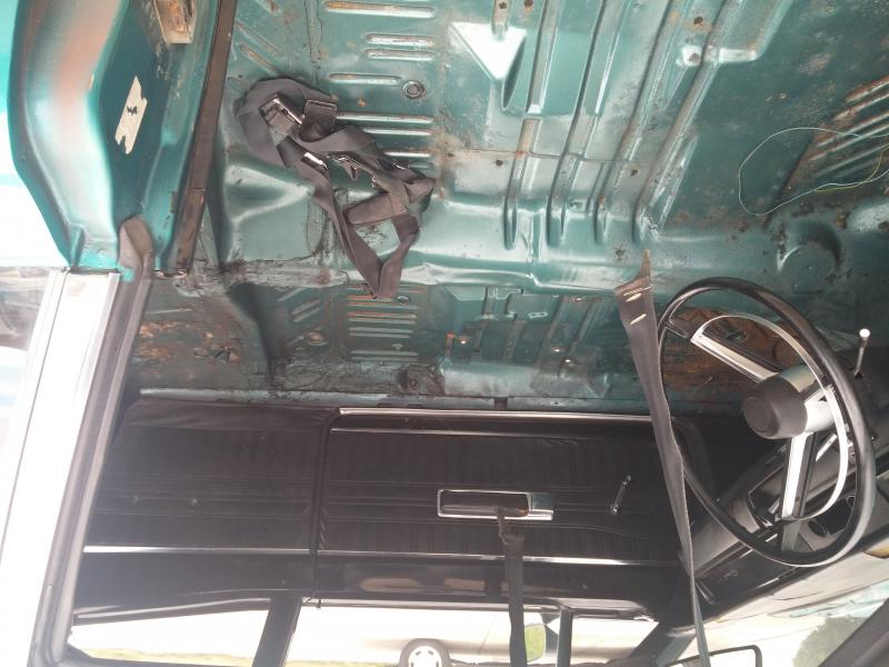

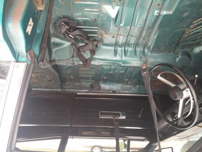

You don't have to completely strip the floor, unless you just want to ! I wire wheeled any rough spots then etch primed all the bare metal. Replaced seam sealer then coated with this sealer. Here's what I started with .... and of course one has to be upside down ! 20150125_194514.jpg20141115_115701.jpg
