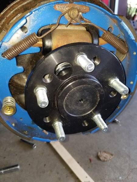

Just installed some axles from Dr. Diff the old ones were trash where someone torched the old bearings off. Just ordered a rear disc brake kit from Dr Diff as well. Not sure if I'm gonna build a 440 or a 400 stroked to a 512. If I go stroker I dont think the 8.75 will handle it . The drums in pic are gone just waiting on UPS to come for the disc. I'll get a disc kit for front from Cass as well.
Real nice! The 8-3/4 is a tough unit, depends on what HP your stroker is I guess. Im lookin to do the same with a 383 and a 438 kit from 440 source here soon. I want to sell my poly and trans before I do the swap though since it runs and drives real good and hoping that helps sell it. I sure don't need it setting around. Hard to prove its a good motor sittin on a stand. What for center section you have in the existing rear?
