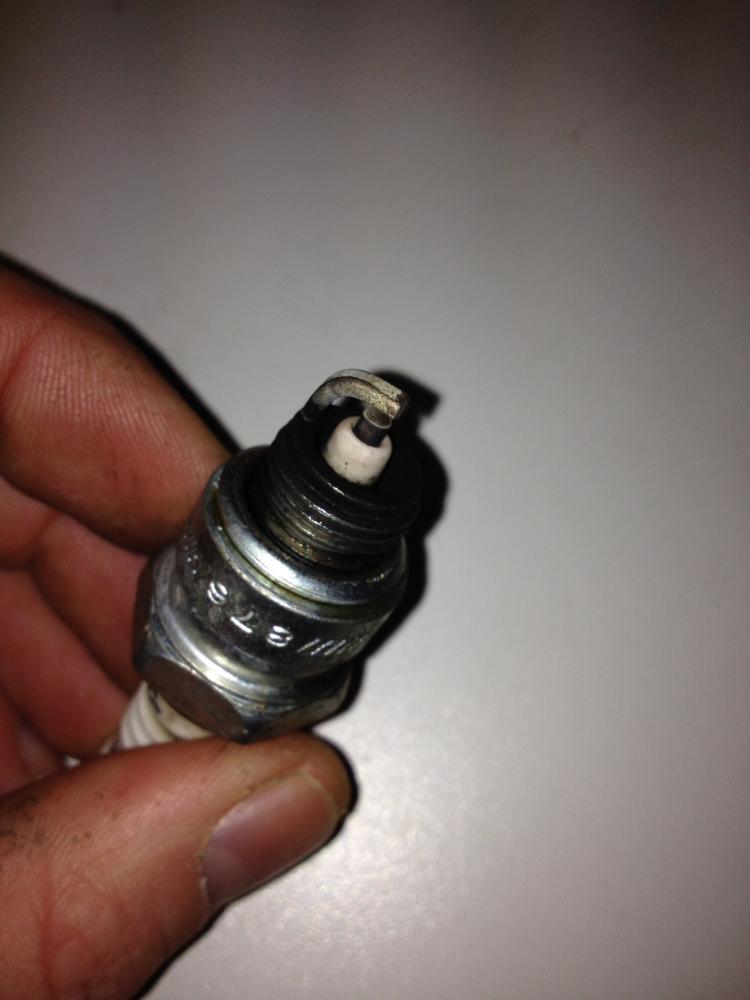

I'm also not shure what to think of the plugs. If anyone have a oppinion of how they look feel free to tell me.
