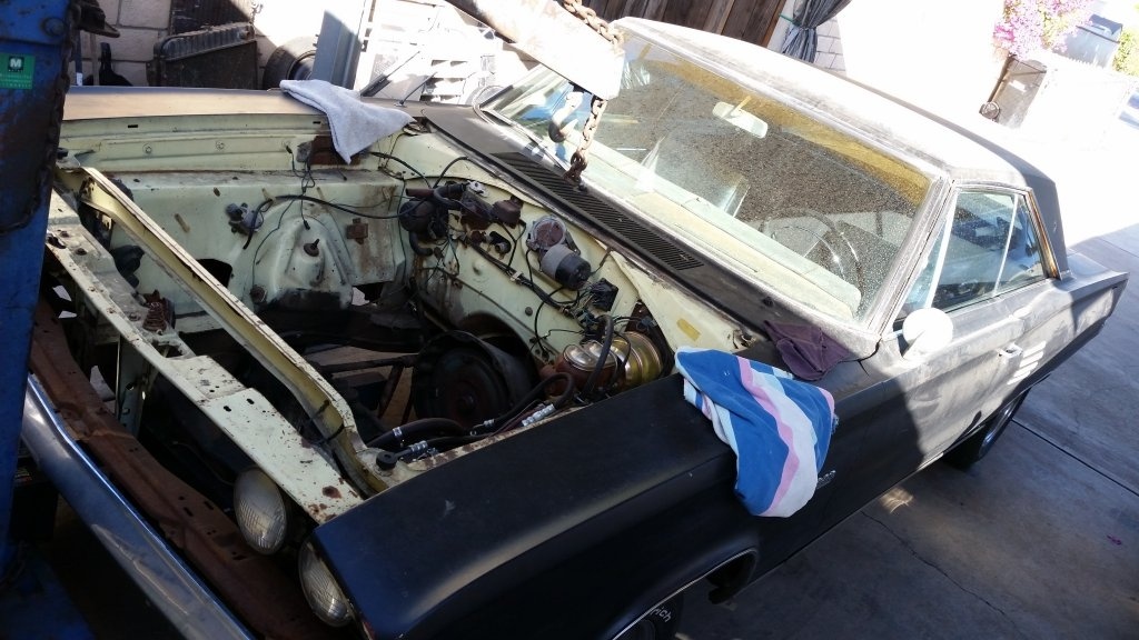

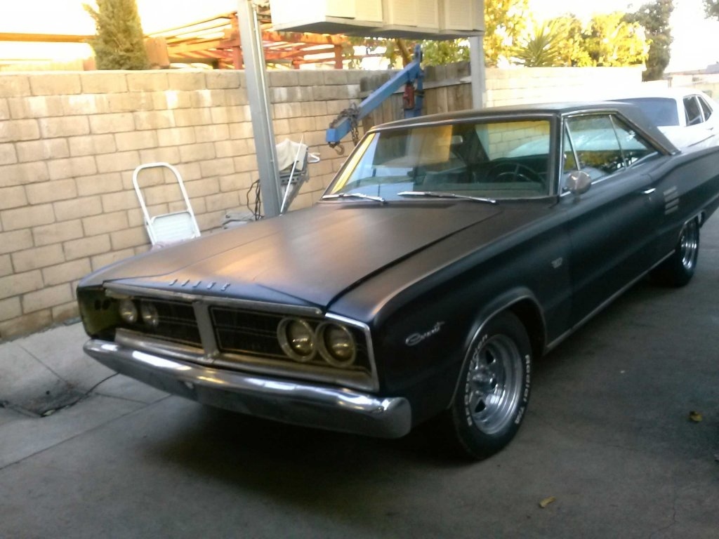

hi all just got my coronet home an starting to take her apart and I wanted to ask if anyone knows of aftermarket k member out there for a 66 QA1 says theirs won't work.
also has anyone used the borgeson p/s kit what did you use for p/s pump brackets in order to use the gm pump any help would be appreciated. Anthony
