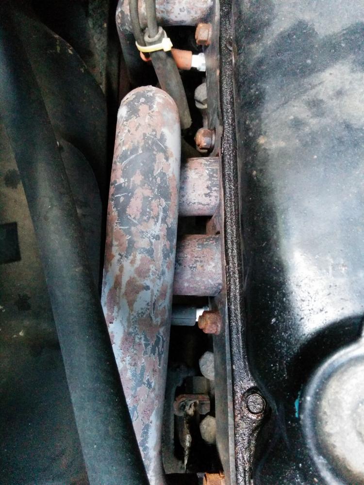

Did put a big block in a 74' 318 car with long tube headers, tight fit, headers had some dents when done. Headers had to be on the motor before putting it in. What a chore. All that to get 200hp out of a motorhome 440. I would recomend shorter headers of somesort in the swap, something you can change the starter without pulling the engine out. My friend owned the car then and we made our own engine mounts. I have read here that you can buy conversion engine mounts to put a big block in a SB K member.

I did this to my 74 RR using a '68 383 engine using the Schumacher mounts. I also installed Hedman headers(#78036 if memory serves me right). I did not cut out pass fender and installed headers by tilting engine slightly to drivers side to slide header in from bottom. Worked fine. Only dent in header was on driver's side to clear end of mini starter. I ordered a new waterpump/ aluminum water pump housing from 440 Source( they have these to exit either side of engine) . Since I was buying a new aluminum radiator anyway I went with drivers side outlet and used 3 Row Champion radiator (#CC375). I am also going with twin electric cooling fans. Using the SB k member is no big deal. As suggested before I would make sure to upgrades the torsion bars.

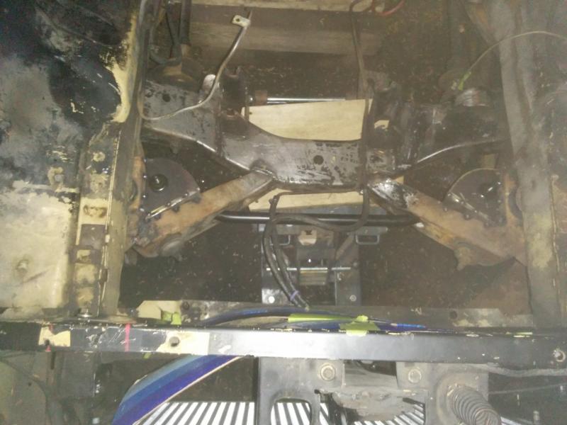

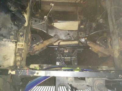

Also if I'm looking at the correct part, it already has a sway bar on the front K member I believe. If it doesn't have the bar attached I'm fairly certain it has the mounts
Ok guys after more research and looking at the pics posted earlier and inspecting my own k member I've come to the conclusion that one of the previous owners had already converted this car to a big block. It already has the front sway bar mounts welded in, and after reading the instructions for the Schumacher mounts, the motor mount has already been drilled and shaved down previously
