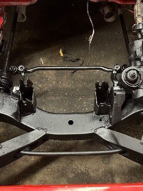

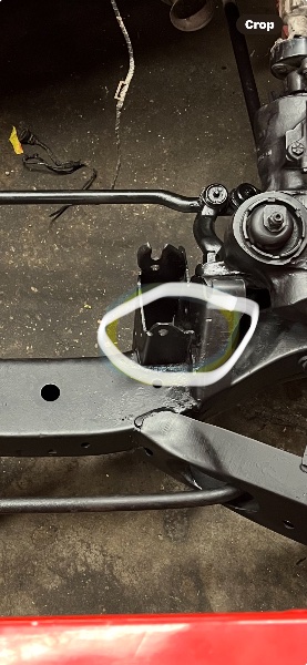

Take a look at the circled mount. I just noticed the ears are gone in the front of the driver side engine mount. Is that an issue? I don’t recall the motor being uneven. Should that be rectified before I install my 440?

what car? Does the bolt go threw the hole? Are the ears just a guide for to set the engine in?
Looks like a 73-up K frame.
Does the bolt go straight through the hole and not at an angle or does it just sit on top?
If the answers are no and yes, which is my guess, then I'd be fixing it.
Kinda looks like it was modified to use the holes beneath the slots.
sorry for the late reply.
The passenger side nestles down into the v-joints, the driver's side has a bolt that goes through the hole. Engine doesn't seem to sit off level. It was originally a 318 car, but it had a 383 when I purchased it.
