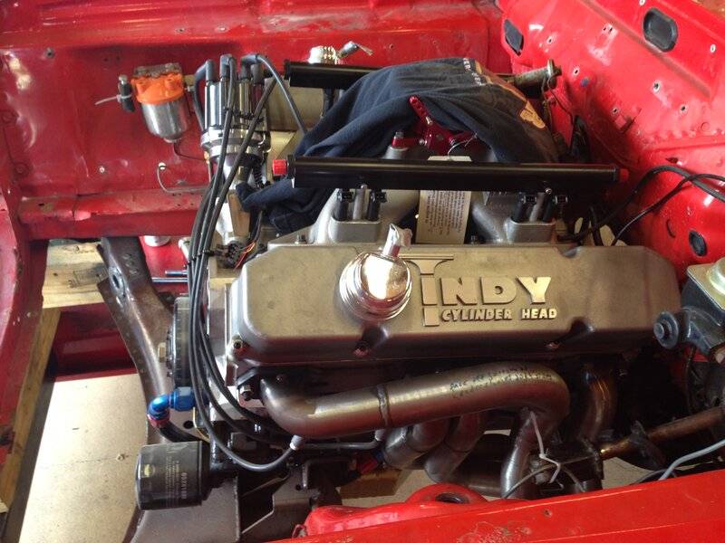

I'm using a 70 unit in mine

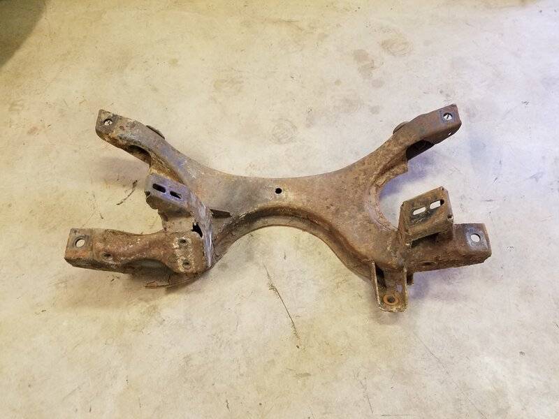

I have a real nice 63-65 big block K frame for sale. If you want to just go the easy route? We ship on a daily basis, let me know.

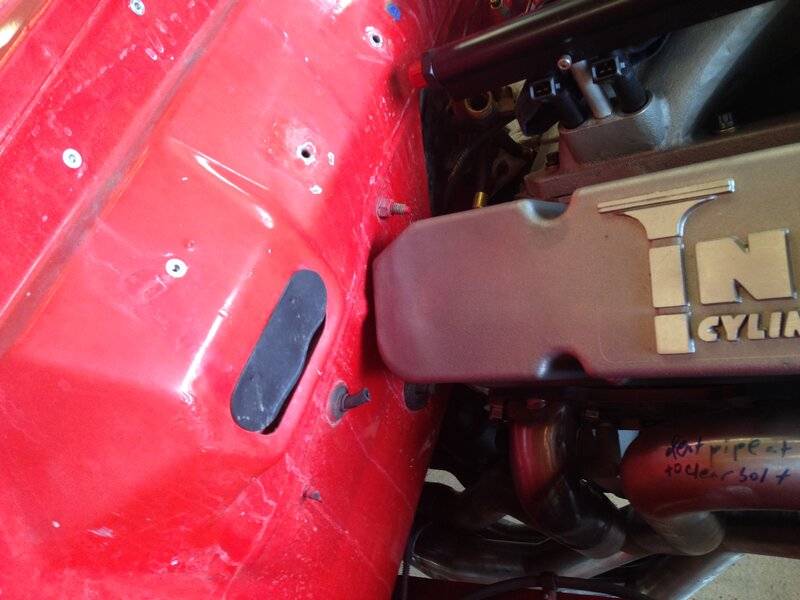

Did not drill any holes. It is very close back there since its moved back. I made a dolly/stand for the engine/trans combo and have been slipping it in from under by lowering or raising my lift. Had to thump the pinch weld a little but there is clearance between the trans and floor for air to get by and cool. I moved all my ac/heat plumbing to between the outer fender and inner. I thought I had shot of it where it comes through the fire wall but can't find it. Its just below and to the inside of the tube brace. Will do the same on the wiring. I capped off all the other holes on the firewall and the inner fenders.
