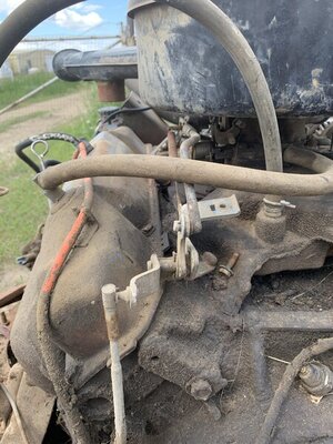

Looking for a kickdown rod for a 68 RR with a 383/727. Part #10 in the pic.
This is the one I have that does not work. The bends are incorrect and it hits on the exhaust manifold not to mention the one shown in the FSM has a clevis on the end. The length on the one in the pic looks to be the correct length though.

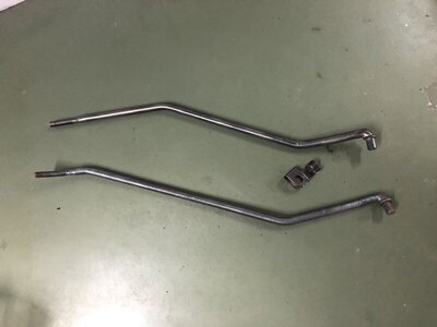

That looks like a small block piece you have. A big block will have the top half straight. And the bottom is attached by the clip in my pic, not a clevis. The top in my pic is big block 440, and bottom is small block.
Also, some say that 383 is a different length than the 440, but nobody has ever shown proof. I think all big blocks were the same length and the height difference is made up by the long length of threads at the top.

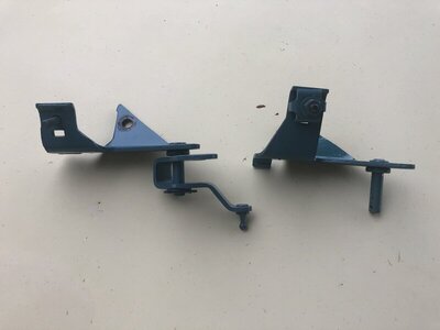

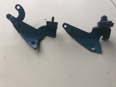

Also, be aware the throttle bracket is different between 2 barrel and 4 barrel. They both position the kickdown in the same spot, so the rod going to the carb needs to be longer with a 4 barrel. But the throttle cable mount is over 1/2” fwd. In my pic, the 4 barrel bracket is on the left and 2 barrel on the right.

Thanks for the info, I double checked and I do have the correct bracket

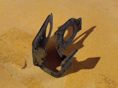

There are at least 2 different bell cranks though, one with the ball stud and one without. The one with the ball stud is wider. I’m not sure what is correct for what though. I pulled these off cars in junkyards throughout the 90’s and didn’t keep track of what they came off of.
The ball stud is 68 and older has a little bigger hole than the 69 up. I think up to 68 is 5/16 and 69 up is 1/4. I’m not home to measure. The 440 rod is 1/4 in longer without the adjuster. 14 inches. 383 13 3/4. I have had some guys say the 383 rod is shorter than 13 3/4. Kim

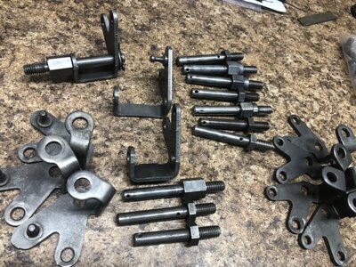

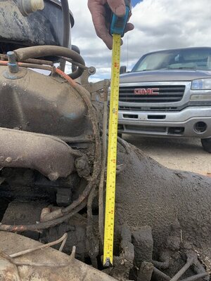

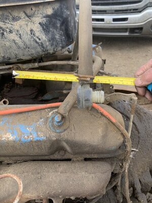

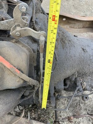

Ok, I just realized I took some pics and measurements of the 2 bbl linkage from a 400 in a truck. The top rod will be too short for a four barrel. Kim
View attachment 1140361 View attachment 1140362 View attachment 1140363 View attachment 1140364
Best I can tell from the pic the dimension is about 14 1/4 but I would be concerned that my HP exhaust manifold would hit the rod. Also there is so much conflicting info out there but one thing I have seen consistently is car and truck rods are different? Could be because of the exhaust configuration? I guess I need to do more homework
