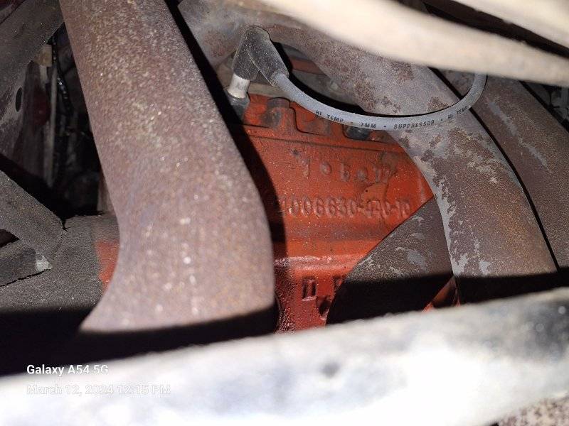

Here are my engine numbers.
1.5.77
4006630-440-10
DN
1.5.77
4006630-440-10
DN

Those numbers mean nothing. Its whats inside that matters. If you do not know the history of this engine or its build, you have no idea if its forged or cast. What if you spend the money on a flex plate or converter and it still vibrates? Myself I would want to know as even in production there was both forged and cast cranks used through the end of the 440 production in 1978. So flip the coin.

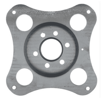

The easiest way to try is by changing your flex plate. To change your flex plate, you do not need to remove the transmission or the torque converter. Unbolt your old flex plate, slide it out and slide in a weighted one.
For example:
The only caveat is I have done this with a flex plate that looks like the below picture (this one not weighted). I have never tried a weighted one of the style shown above. I assume it would still fit through the inspection cover, but don't know for sure.
Good luck!
