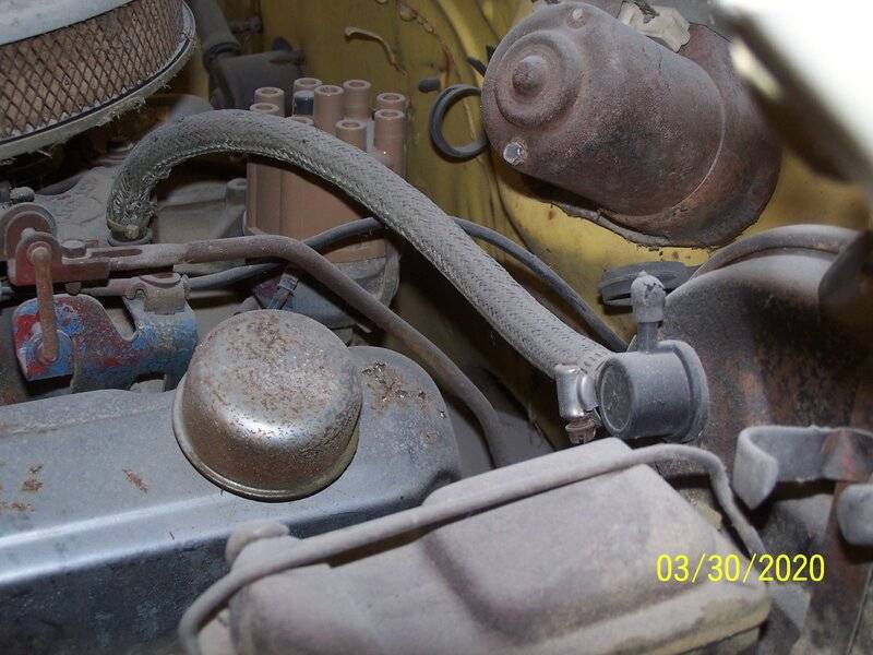

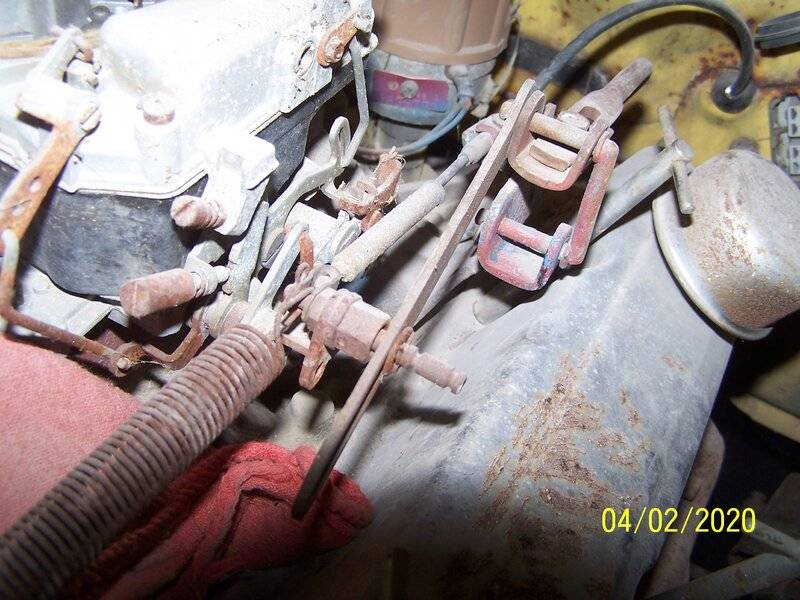

The picture of your linkage doesn't make sense or even look like the correct linkage. Looks like an aftermarket shifting cable.
Need better photos that show the entire linkage connection to the carb. Looks like more than 1 piece is missing.
Everything looks pretty dirty/grimy there. Have you ever driven this car ? If so, did the tranny work properly with the exception of the kick down. The reason is, if the fluid level is too low and the car was driven for any period of time without the kick down connected. You like will need to rebuild this trans mission as the kickdown controls the transmission internal hydraulic pressures and without the kick down hooked up, the transmission doesn't get enough pressure and the fluid/clutches overheat and burn.

Hi Paul. I think if you go to Lokars web site, you should find the instructions for the cable set I mentioned in my last post. Also, one of the Mopar mags, I think it was Mopar Muscle, had a how to article a while back on using this cable set. The mag is gone, but their archives are still available. Happy hunting!!

Unfortunately it doesn't look like it was well cared for.
Your neutral safety switch has nothing connected as well.
And yes if it's been driven much the way it sits, you quite possibly need a transmission rebuild.
That very well could be why the car sat.

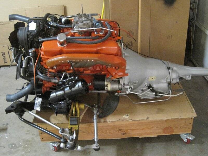

Maybe these will help, maybe not.
View attachment 1235982 View attachment 1235983 View attachment 1235986
