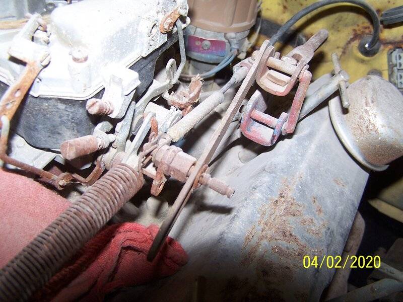

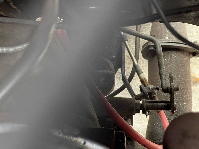

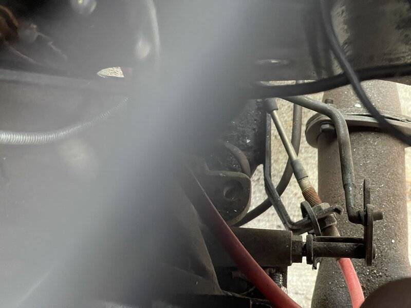

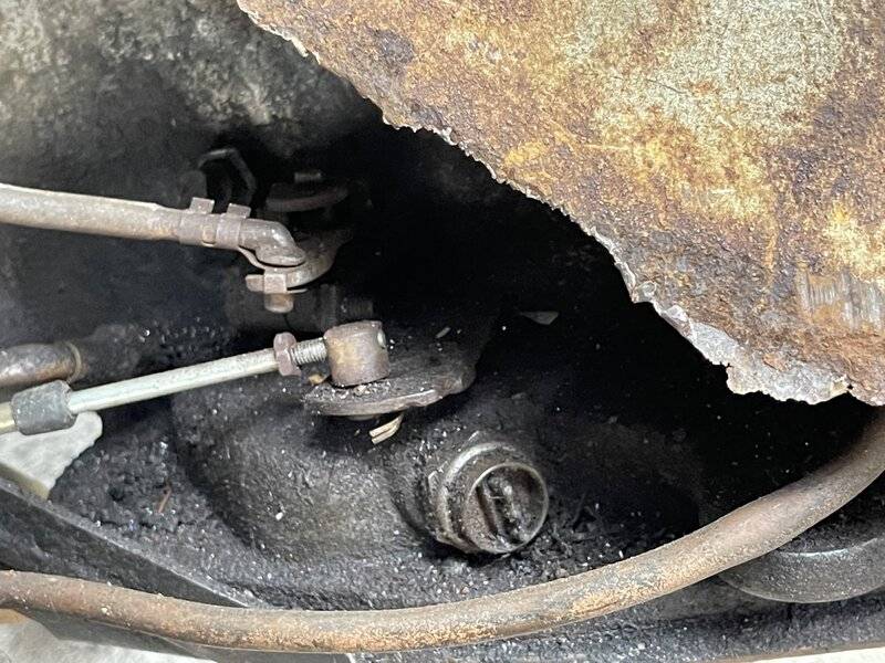

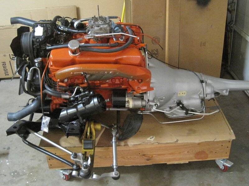

I have a 1973 Roadrunner, it has 1979 360 with a Holley 650 carb, 727 transmission has headers, It appears it has a 3 piece kickdown linkage , I am missing the middle piece, I tried eBay, looked at cable systems,
The car had not run in a couple of years, and trying to get it to be a daily car, , I have only had the car 7 months, learning bout mopar.
I read that the headers, may get in the way, and may need to modify the piece if I find it
Looking four any suggestions. I have included photos,

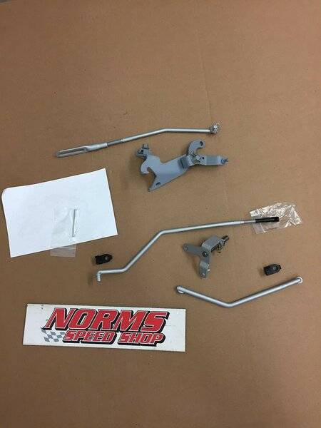

Greetings from Canada!! :canada: If it was me, I would go for a Lokar Mopar kick down cable. You can get them at Summit Racing for a reasonable price. They are super easy to set up, and more important they work. I would take a guess that some one ditched your missing part(s) to maybe get the headers to fit, etc... Who knows? Even if someone has your missing part, ( and on this site someone will ) reinstalling it will likely show you why the part was removed in the first place, taking you back to square one. Lokar also do a set that includes a new TH. cable as well as the kick down. Perhaps change both. Just my 2 cents worth. Best of luck with your car and again, WELCOME!!
Welcome from Alabama, I can't help you with your problem, but TCI may be able to provide a cable system that will work for your application.
The picture of your linkage doesn't make sense or even look like the correct linkage. Looks like an aftermarket shifting cable.
Need better photos that show the entire linkage connection to the carb. Looks like more than 1 piece is missing.
Everything looks pretty dirty/grimy there. Have you ever driven this car ? If so, did the tranny work properly with the exception of the kick down. The reason is, if the fluid level is too low and the car was driven for any period of time without the kick down connected. You like will need to rebuild this trans mission as the kickdown controls the transmission internal hydraulic pressures and without the kick down hooked up, the transmission doesn't get enough pressure and the fluid/clutches overheat and burn.
It doesn't have to be low on fluid, just driving around will get your gears, starting with drive, then 2, and eventually no movement.

I'm not sure what middle piece is missing? Headers can interfere with kickdown linkage. In my experience modifications are required. Bends to get around the header may be needed. An aftermarket cable system may the answer. Don't know, never used one. Good luck.

Unfortunately it doesn't look like it was well cared for.
Your neutral safety switch has nothing connected as well.
And yes if it's been driven much the way it sits, you quite possibly need a transmission rebuild.
That very well could be why the car sat.

Probably best to go with a Lokar cable setup as what it sounds like you have a mix of years and trying to get the right linkage is about like trying to get the correct pulley belt setup as they changed the design every year.

For the budget minded. If you do decide to go with cable kickdown your local Auto parts store may have a kit from Spectre.
About $34 to $49 bucks. They also have them on E bay starting at $26. Different brand name looks the same.
I run the Spectre on my 63 for 4 years now.Got it at AutoZone. Works fine.
