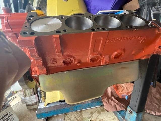

ok engine builders. Here is my dilemma. I bought a Mabbco rebuilt 360 short block from a member. Some upgraded stuff like KB high compression flat top pistons, moly rings, 272 muscle cam (272/272 duration 454-454 lift) Cloyes HD timing chain and sprokets. .30 over bore. Got a nice brand new set of Speedmaster aluminum heads with 68cc combustion chambers.
Here's the problem; my engine is at a builders for finishing. Went by there yesterday and he said this engine will be an absolute dog as it sits now. He doubts it will make 8:1 compression. Yes, the pistons are below deck a little, but he says I am losing a lot of quench with them. He suggests new pistons, rods, roller cam and new crank. That's an expensive prospect, considering what I already have in the motor. Also, this guy is a very well known builder with a great reputation and is well known in the racing circuit. His shop is incredible and he rebuilds engines for a living, and has many many great reviews. He does not even want to assemble the rest because he says he knows I will be disappointed.
What to do? Will this motor be a dog like he says? I don't know that I have the scratch to have him tear down this motor and upgrade it to a stroker.
TIA.

@71Beeper Its been decided that these are not the 107's like the seller told me. They appear to be stock replacements, possibly KB's but not 107's.
Matt, you would be correct - those are not 107's.
If cylinder #1 in the photo is at top dead center, then you definitely have alot of deck height that can be removed.

It certainly will make more power at zero deck. I'm assuming .030" over. At Zero deck it'll be arond 10.8, -100" in the hole 8.7, -.150" in the hole about 8.0. Right now it'll run on 87 octane. I built a similar Magnum motor at 8.0-1. Hyd roller, Eddy head, RPM intake, 650 Eddy carb, headers. 3.23 with a low gear set 904. It ran very nice for a street motor in a 68 Satellite convertible. By the seat of the pants very low 14 or high 13 second car. The 360 in my Challenger is 9.0-1, ported factory heads, .220 hyd roller, LD340, 650 holley, headers it's been 12.70's w/3.55. With full exhaust and air cleaner in place. At most the difference between 8.0-1 and 11.0-1 is roughly 10% or less. At max 40hp. At 9.5-1 5% or 20hp. But with the small cam you are using the difference will be even less. So if you want to run premium fuel? The easiest thing right now would be to swap pistons. Reuse the rings. It's already honed fresh. You could mill and deck. But then everything has to come apert. Intake will need to be cut. Pushrods will need to be custom length.
