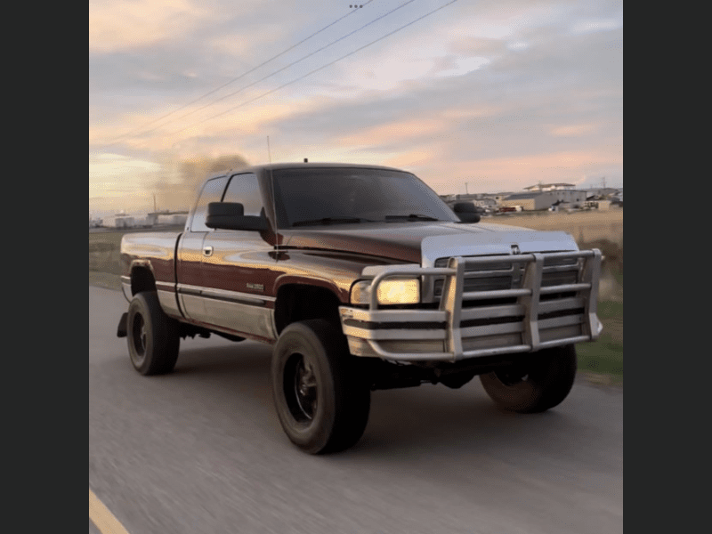

Lil Buddy! He’s 16 now. Got his license, a stinky rusty old Dodge Ram 2500 with a Cummins in it. That, working, rolling coal and being a little red neck takes up all his time and money. Lol. No time to go racing at this point. He got **** the other day, suddenly a 12” pipe is sticking up behind the cab making everything black. Big injectors, straight piped, big side flares that don’t cover the rot holes is what he and his redneck group are all into. But sure a hell of a lot better still than those walking around with pants around there knees and trinkets protruding and attached everywhere.
The good side. Look at the cloud behind the cab, the black window must be from the cloud rolling in the rear window. One day he’ll come swooping back to the track.
Good you have kept him out of the woods for the part. Yep he'll be back and learn some more life lessons from you that has been there and done that. Best of luck this weekend to you. Keep us updated some of us have to live thru your post to keep us going.
