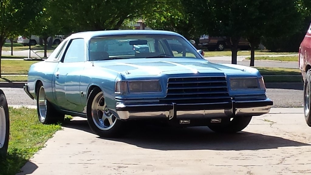

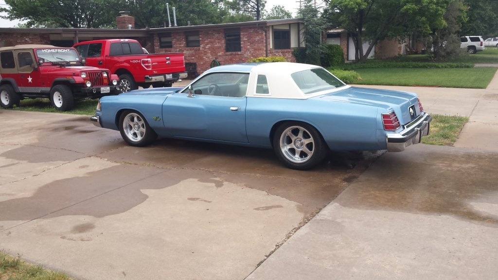

Hello gentlemen I'm new to the board but I ran across this thread and like to help with my experience. I own 2 78 magnums and I'll try and post pics.
I have 275 60's on all 4 corners of one of my magnums. 8" wheels and no issues. Remember the magnum gt of 79 had more or less same size front and back on 15x8 cop wheels like the volare/ aspen super coupes
My other will show how great a 17 - 18 combo looks on these late b bodies
Blue car has 255 50 r 17 on a 17x8. Rear has 295 45 r 18 on 18x9. They are sport truck tires but who cares. The stance is turned down bars 1" blocks out back with shortened rear leaf shackles.
The ratty grey car is bone stock

Also if it helps . I always just grab 2 wheels with about a 4 to 4.5 backspace with 275 60's mounted. Use this as a base line and go from there. And the 295 45 18 sounds like it be too big but it's only 1/2 " taller over all than a 275 60 15. All this works for the 71 -74 b bodies too.
View attachment 342113 View attachment 342116 View attachment 342117
That blue car has a great stance! Not familiar with those wheels; any info on em? Planning a similar combo with my 78. Once the engine's built, trans, interior, etc...
Thank you brother. Sorry for the mia lately. The wheels are Enkei rt6. I got them in 2003 so good luck finding some. They do make a similar style one just look at their Web site. You can also look into custom wheels for like a 87 -95 jeep wrangler as its same bolt pattern and there will be options as far as 16s thru 22s. My particular wheels have all 0 offset
Bs 4.5 on front bs 5 on back
